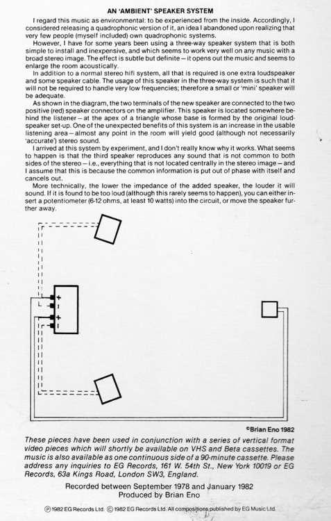

I’m sort of piggybacking on the current/ongoing Hafler free surround sound circuitry discussion which brought to mind the Eno system.
In the liner notes of the LP for Ambient 4: On Land, Brian Eno wrote about a 3 speaker surround sound system and included a diagram of the suggested set-up. The third ‘ambent’ speaker was added by attaching it to the positive terminals of the left and right aux speaker outputs on your stereo, and then placed behind the listener’s chair  halfway between the two main speakers with the speaker placement forming an equilateral triangle, with the listener in the center.
Eno quoted: "I arrived at this system by accident, and I don't really know why it works. What seems to happen is that the third speaker reproduces any sound that is not common to both sides of the stereo - i.e., everything that is not located centrally in the stereo image - and I assume that this is because the common information is put out of phase with itself and cancels out."
I had a buddy on the West Coast who tried this and raved about hearing music ‘lost’ in a traditional 2 channel system. I never tried it for fear of blowing up my amp, or speakers or both.
Did anyone try this?

Cool. Learned that trick many moons ago from Scott Markwell. I run wires from the amp to two speakers behind listening chair 2 ft apart wired out of phase to front speakers. A passive preamp is used to control volume. Key is NOT to hear rear speakers. Fills the room more.

With this 3th speaker the impedance for the amp will drop?

I have my upstairs system wired using the Ambient 3D system Eno came up with and on some source material (a lot, actually), it will provide a much larger sense of envelopment than regular two-channel audio. It seems to be most effective with the volume turned up at least loud enough to impede conversation so the ambient info coming out of the single rear speaker is noticeable. I’ve not had any issues with blowing up the receiver or anything like that and I first tried this connection about 10 years ago. For folks who want to expand the ambient audio effect without going with full surround, you may want to give this a try. Personally, I’d love to hear the same set-up in a car audio system!
