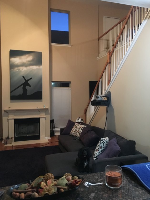

Hey all...
I love room treatments with boxes. But with Maggies, I've typically found that less is more. I definitely don't want to treat the front wall, by my couch is right up against the rear wall. I'm a GIK guy, and I was thinking about adding some of their new combination (scatter/diffusion/absorption) panels since they have a design that would also add to the decor. Usually I wouldn't care that much about aesthetics, but in the living room I'm trying to keep it from looking like a man cave.
My speakers are the 3.6r's.
I think since it's a very open room, I'm already getting surprisingly good sound. Just want to tweak a little bit more out of it.
Any and all feedback is appreciated.
If you reference the image, what Im considering are a couple of square panels on the far side of the couch running beneath the projector, and then in the more open area I'd add a couple of the rectangles.

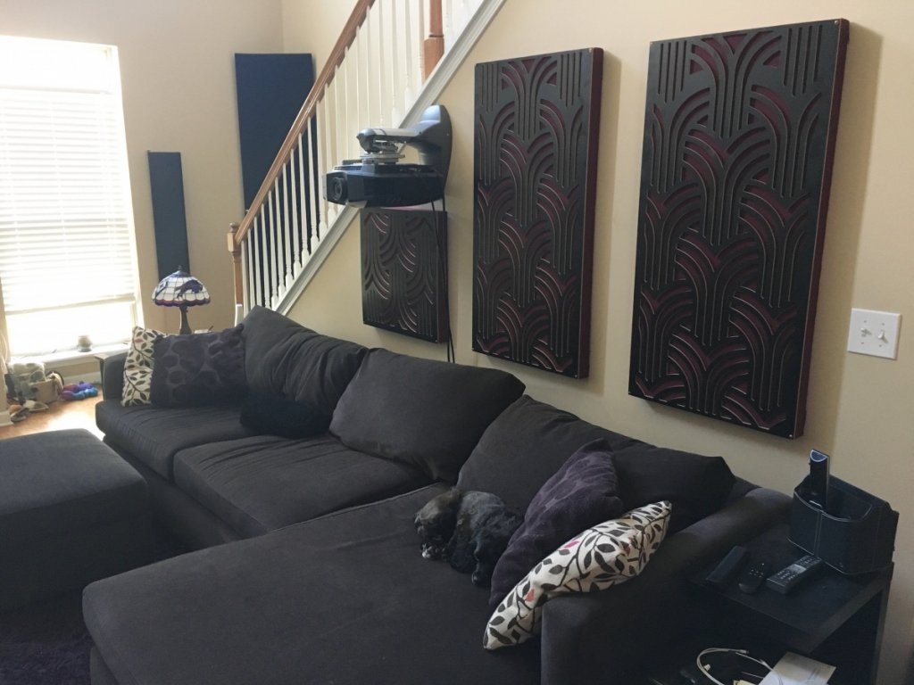

ajzepp
Re: Rear Wall Treatments
« Reply #8 on: 25 Jun 2018, 02:51 pm »
Love me some GIK...the center speaker dialogue has already improved in clarity after installing these.

ajzepp
« Reply #10 on: 1 Jul 2018, 06:00 am »
They certainly look cool!
I'm in a similar situation -- up against the wall, so to speak. Conventional wisdom says absorption if you're too close -- diffusers need some distance to do their thing (but not sure about scatter plates like you have). I just ordered some 703 from GIK, plan to play with that . . .
Thanks man, I love all the options and creativity GIK allows...I thought about putting some more art panels behind me, but the hybrid option became more attractive when I saw the new designs.
At first I thought I was going to have to re-run ARC, because it really altered the sound I already had dialed in. But after some experimenting (and I still may re-run ARC, just because it's awesome), I found that after changing the toe-in angle, it was like fine tuning the FM dial on those old radios...all of a sudden the sweet spot kicked in and it sounded great. The center sounded improved right off the bat, which was what I was hoping. But I feared I screwed the 2-channel playback after first installing them. All is good now, though.
Hope your GIK additions go well! Pics are always welcome  :thumb:
