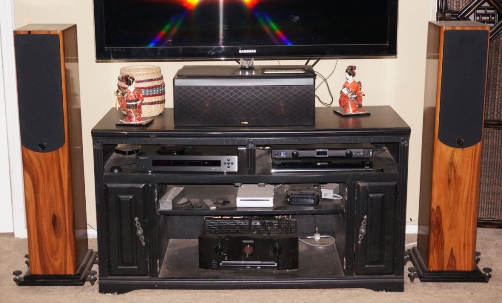

FWIW... more "data points"... room constraint photos/layout. The mini's come in at about 47" tall... would be nice to get something smaller height wise... possibly monitors.

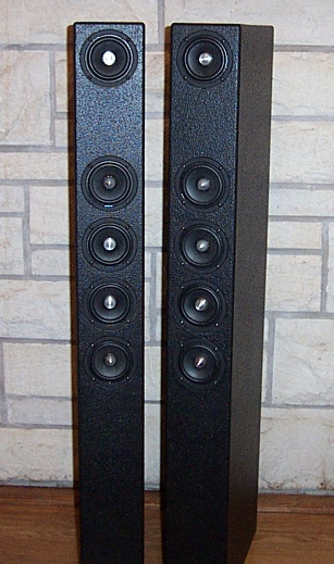

Another option would be the Skinny 6 ( http://gr-research.com/skinny6s.aspx ). They are 41" tall without a base (41-3/4" - 42-1/2" with a base). While that is not a whole lot shorter than the Minis, the Skinny 6 is only 4-1/2" wide and 13" deep. They need a sub but then any speaker will need a sub for movies.

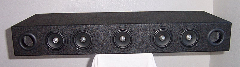

The Flat 5 is the matching center channel ( http://gr-research.com/flat5.aspx )

Your right speaker is right up against the wall with zero wall treatment. It doesn't matter what speaker you place in that fashion the effect will be the same. The off axis response will reflect right off of the wall and combine with the on axis response with a slight delay. That time delay will cause an out of phase cancellation that will cause a huge hole in the response. And by a huge hole I mean a 15db dipped out area. You will also likely have them in two or more spots. So the response will be all over the place.
You also have a walled in area behind the speakers with no bass traps or damping material to absorb low frequency energy. So it would be real easy to get real boomy bass especially from anything rear ported.
So keep in mind that the room is part of the system and you'll really need to pick speakers for that space and do some work to the space to make it more ideal.
As for speakers I would go with Mike Lundy's recommendation for our Skinny 6's and a Flat 5. They are the only speakers that I have designed for applications like that.
First of all they use a 3" wide band driver. The important value in that is a limited off axis response compared to a tweeter. So side wall reflections in the upper octaves will be more limited than designs using a tweeter. Secondly they will hit -3db ranges in the 60Hz to 80Hz range and will really minimize any room boom from the walled in space behind them. You can then adjust the ranges below that with a separate sub woofer. That is one of those applications where adjust-ability down low will be very important. Also the rear firing drive on these help make the space sound much bigger and open. This really helps in small spaces. And the narrow baffle will allow you to pull them in as far as the edges of the screen and get them out from the side wall on the left and away from the side wall on the right. This will minimize side wall interaction too.
The matching Flat 5 is also perfect for the the top of your equipment rack. And the three of them will match and sound fantastic. I am using them in my personal system, and love them.
On top of that I still highly recommend wall treatment to the wall on the right side and behind the speakers.
