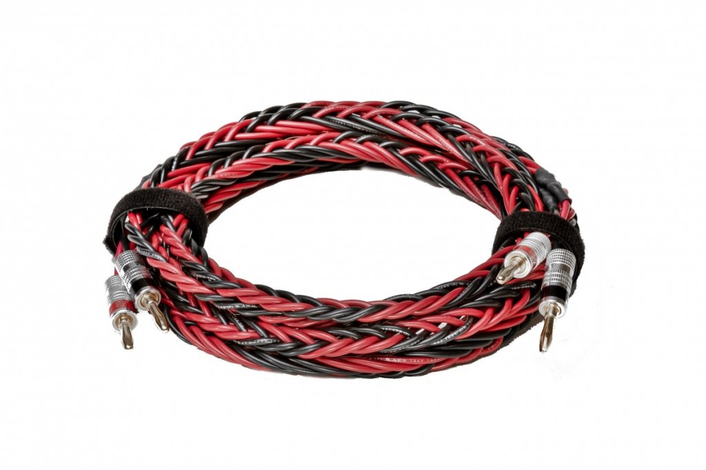

Now, we have speaker cables available, although we don’t push them or try to make any significant margin on them.  They are designed for easy use (physically flexible) and LOW RESISTANCE!  Our current top-of the-line model is the MEGA Snake, a 9-gauge equivalent cable!  Here’s a photo....
Fact is, there are many companies, and individuals, that make up problems so they can “solve them”.  This stuff comes from marketing, not engineering.
