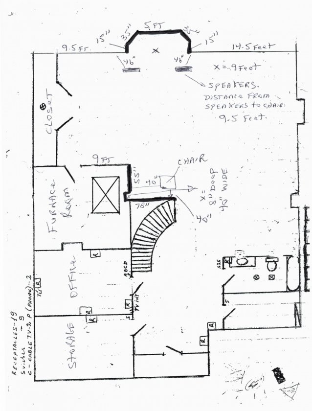

I have attached a drawing of my situation.
This is the basement of my home.
It is completely finished with drywall on all walls and ceiling. The celing is about 7 feet high.
The drawing is NOT to scale - particularly the distance from the speakers to the chair.
Here are some notes:
1: the areas that I am most concerned about are marked in dark marker:
The areas behind the couch and the area in front of the speakers.
2: the speakers are Apogee Duettas - which are dipole ribbons. So the sound emanates from the front and the back.
3: in case it is not clear: the width of the room is 33 feet (9.5 feet + 14.5 feet + 9 feet for the width of the alcove behind the speakers.)
I think you can see why I consider this area to be more of a "space" as opposed to a "room".
Any direction that can be offered would be great.  If you can point me to actual products that GIK makes  so that I can see what they are would be great!

That is an awkward set up! Can you place the speakers and chair elsewhere in the room. I would suggest that finding the best locations is the start, then look at room treatment.
The way you have it in the diagram seems too lopsided for balanced sound from both speakers. The left speaker is directing sound onto a wall nearer then the right speaker, and also against a nearer back wall. You could try a diagonal arrangement which some have had success with and which I would think could suit your situation. The speakers would be placed either side of the top right corner with your chair roughly where it is now. You should then move the speakers and chair around a bit to get the best, most balanced sound. It takes time to do this but should be worth it. It can help a lot to use a measuring device to do this, but that will add to the learning you need to do. Room EQ Wizard is recommended (there's info on the GIK site about how to use this).

From what I can gather the top/right corner looks to have a clear floor space of about 18 foot x 20 foot before running into the highlighted corner where the chair is shown.  Can you center the system closer into that corner (speakers centered 9 - 10 feet from the corner)?  Should be enough space, even with dipoles, oriented either way or as Hipper mentioned on an angle.  Best to keep the speakers and the listening position away from walls to minimize room effects.
You are correct - it is an awkward setup!! But unfortunatly it is what it is - I can't move it anywhere. A drawing just represents an area but in real life what is blank on the drawing is full of other "stuff" in real life.
Quote from:
I know all too well!
Quote from:
After that, listen to GIKs advice.
As mentioned above - I can't move anything - so I did contact GIK today and dealt with a very nice young man named Zak who sent me his suggestions and a quote. Now I have to figure out how to pay for it!

Thanks for the reply JLM. I wish I could move things around but I can't. I just have to make the best of it. Truthfully it really is not that bad - surprisingly - but I want to make it as good as I can.
