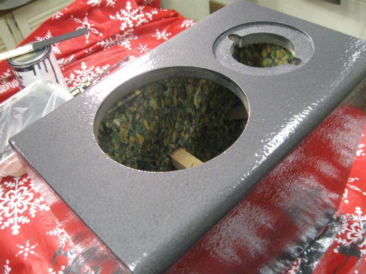

I built a set of GR Research X-LS Encores to hang up in my gazebo out of 3/4" MDF.
Used several coats of a hammered paint for the finish and they've held up really well... better than I expected.
They hang up high in the gazebo and do not get any wind-blown rain or direct moisture.
I'm in the NJ area, and the summers can get a bit humid.
I do bring them in during the winter... not sure if it would hurt them... but more of a habit.
Took them out during the warm spell we had last weekend and after 6 years they look absolutely fine.
Good luck!

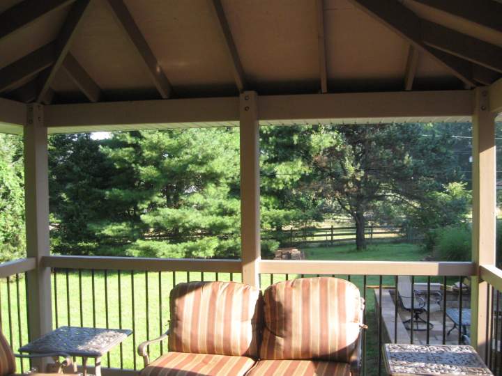

The X-LS sound great inside the gazebo, which measures 12' x 12'. Of course the sound radiates outside into other areas of the deck and patio and provides pleasant ambient music. I'm not pushing them hard with heavy rock and such, so personal preferences may vary. I have built a few of these speakers for others as gifts and they always impress. The pair in my gazebo have extra damping added to make them very inert (and heavy).
I spoke with Danny at GR Research to get his thoughts on how well the drivers would hold up in an outdoor setting. His take was no issue with the tweeters and the woofer should last quite a while. Each winter when I pull them down I take a peek and they look as good as new.
As I said, I have been really impressed how well these have held up over the years. For reference, here's a picture of where the speakers are placed. This was before I mounted them... they sit on platforms mounted on the top header and sit between the roof joists.

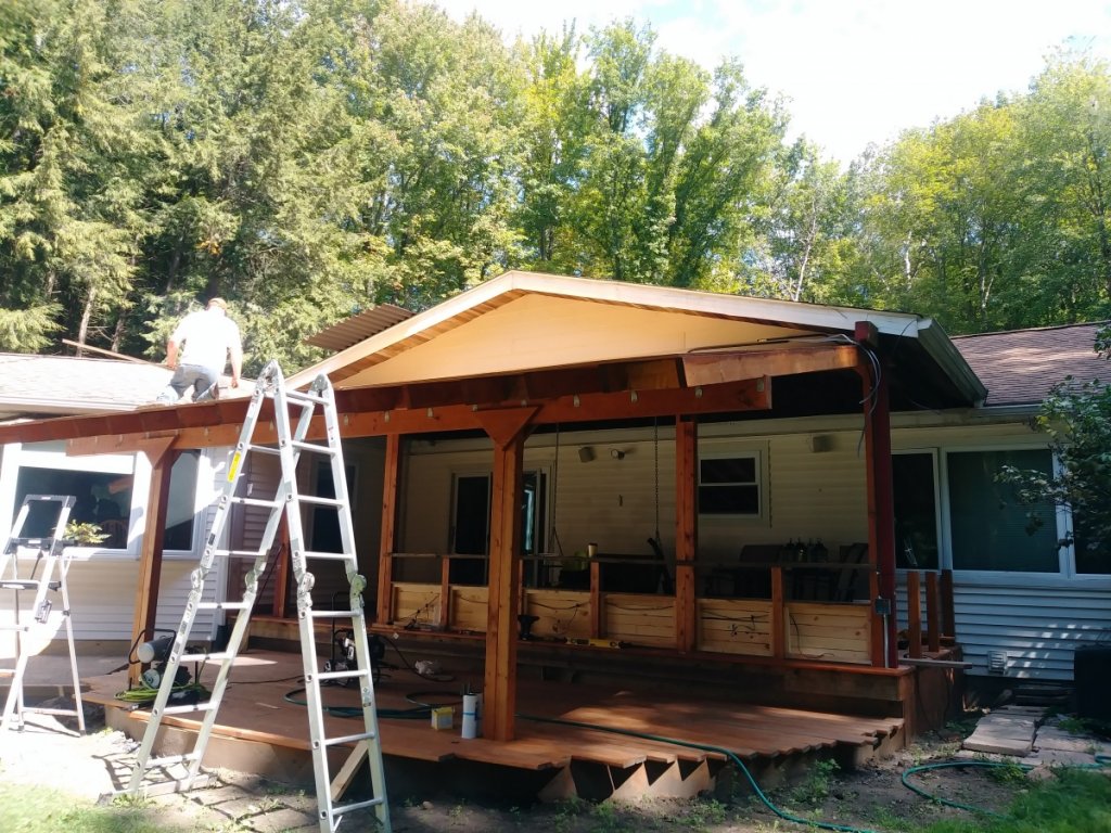

« Reply #11 on: 27 Apr 2018, 10:26 am »
The deck has been completed since this photo was taken.  I was planning on mounting the speakers either to the house or the columns closest to the house.  Wanted to mount them in such a way that I could pivot them to direct sound a bit (going to build a bar into the lower area of the deck so I imagine that is where most of my time will be spent)
