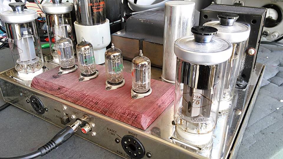

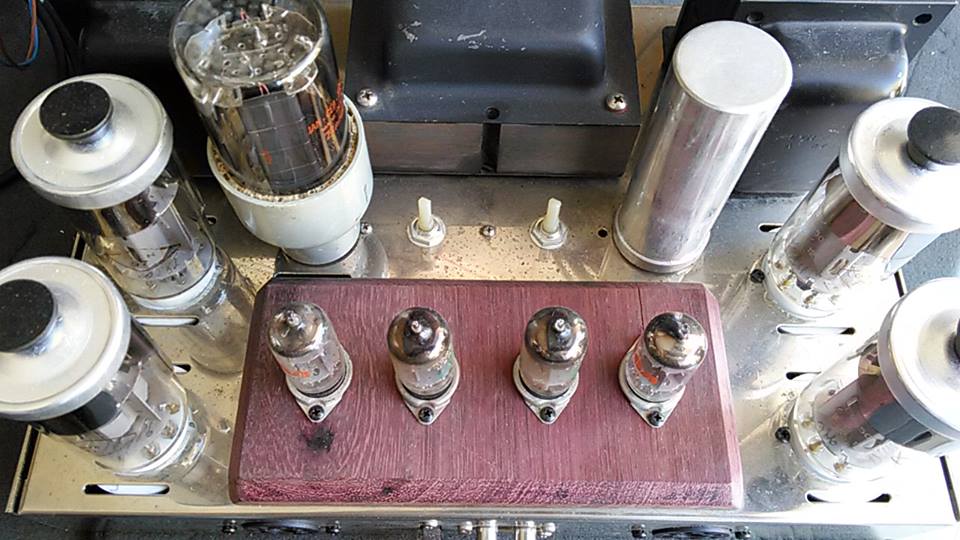

Hi all - Sorry for abandoning the post for so long.  It took me until this spring to finish up all the rebuilds and tweaks, but it's all finished now.
As mentioned previously, I had two Dynaco ST-70s, one a kit that my uncle built in 1964, and the other a factory wired version made in 1961.  I purchased two of the blank VTA PCBs, then used a combination of new purchased parts and some excellent Convergent caps I've had on hand a while.   In all, new tubes throughout, new quad caps, and new inputs and outputs.  I finished the first amp near the end of January 2020...it took me a couple of weeks to work out some soldering bugs and to burn in all the components before making any serious evaluations.  At about that time I also decided to add the toggle switches so I could flip back and forth between triode and ultralinear mode.  (I ended up with a preference for triode mode, but at least now I have easy options to switch)  In a nutshell, I was extremely encouraged by the results I was getting, so before getting started on the 2nd amp, I decide to scrap the junk CCA speaker wire I was using and replace it with some more appropriate 4 conductor OFC 12 awg.  Then got started on the my 2nd ST-70 with the same mods.  I found the amp updates to be fairly straightforward for someone with basic circuit knowledge and some soldering skills.  Bob Latino offered great support through his website...much appreciated.
As fate would have it, once the 2nd amp was done and working as expected, my 25 year old Lazarus Cascade Basic preamp starting making some impolite noises, so I ended up recapping that, replacing the power supply resistors, and adding 4 new 12AX7s ...that made the whole thing a bigger project than originally anticipated, but thanks to Covid-19, I had time!
Per Bob Latino's comments, I hooked everything up in a vertical bi-amp mode with separate amps for each side, and was really pleased with the outcome.  Enough so that I upgraded the stylus on my TT, and added a more modern DAC to my CD.  All-in-all the speakers are about the only part of the chain that's unchanged, and I'm very, very pleased with the sound I'm getting from the system.  A great way to spend some of the quarantine time.
For anyone still following this thread, I ended up taking the system a bit farther than originally planned.  Since 2023, the bi-amp configuration went from vertical to horizontal (or at least a hybrid of horizontal).  I added a solid state Kenwood amp to drive just the main woofers of my speakers, which included bypassing the passive inductors and adding an active crossover at ~ 65hz.  The single channel tube monoblocks now drive just the midbass and tweeters.  (Best of both worlds IMO...impressive improvement)
I also switched the rectifier tubes to SS with Roy Mottram's copper top rectifier with a 12102 thermistor and some diodes.  The driver tubes are now a 12BH7a instead of 12AU7, and the output tubes are Tung Sol 7581A.  After many iterations, I've been incredibly happy with the sound of the whole system.
