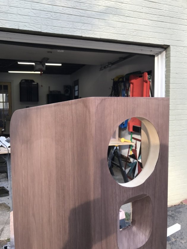

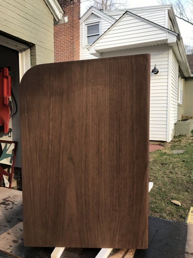

This is my first time working with Transtint. I got the color dialed in on scraps and then moved on to the big stuff. I used about 75% denatured alcohol and 25% water for the medium. I was working pretty fast so I wouldn't have thought that the evaporating alcohol would have caused this double staining effect where the wood got stained more. But I really don't know. I've never had this issue before with your standard big box store stains so I'm at a loss. Is this salvageable? I don't really think I can sand it off as the veneer is already pretty thin.
Thoughts besides light it on fire and start over?

Hi, If you have not put a clear coat over it, just rub it down with some denatured alcohol and blend it out. I would stay away from water usage.

Thank you so much, I was a little depressed there for a day or so. It came off just enough that I could re-dye and blend it all together. It looks great now.
