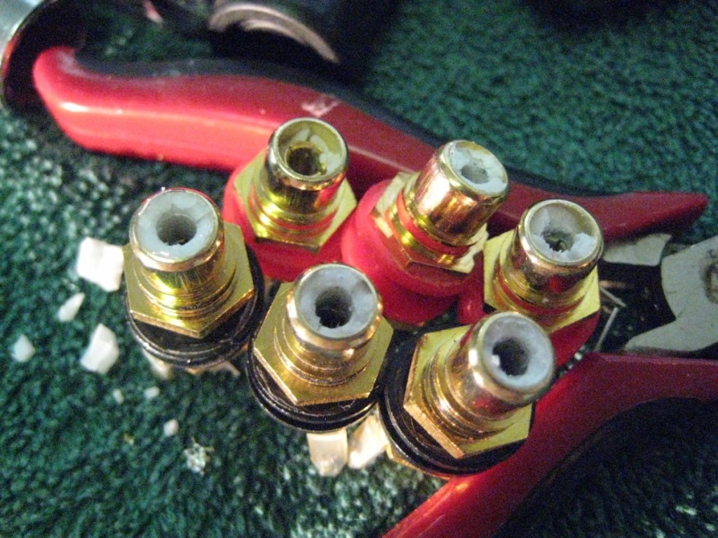

 About six months ago I used an electronic contact cleaner from a well known vendor and noticed today that all 6 of the
female RCA’s dielectric insulation is breaking up in pieces and turning into dust. Luckily my RCA males are okay.
I don’t have the can anymore so I can’t say 100% what I used (was not de-oxit) or if it said “Plastic Safe” on the can. I doubt it did.

WireNut
Re: Chemical damage from contact cleaner
« Reply #8 on: 10 Mar 2018, 09:52 pm »
Whether you build them yourself or not, always look for pure teflon dielectric, as it wil be impervious to almost any contact cleaner you are likely to use as well as being the best sonically. Polystyrene can sound quite good but it is fragile and has a low melting point, polypropylene is also good sounding but has a similar problem with heat making soldering difficult.
 Scotty
Agreed.
The only problem is when you purchase a component you don't always know what was used in the construction.
I know Teflon is great, If I installed the RCA's myself that's what I would have used.
Have a look.
Notice the white particles on the left. That's the dielectric.
The center pins where so loose, they had nothing to hold them in place anymore.
I've never seen this before in my 40 years as an audiophile but It has taught me a lesson.
I'm lucky I found them, as it may have taken years before I came across it.
Again, I'm just putting this out there to be careful about what you purchase for your equipment.
It's all good because an hour of time and some solder will fix it right up.

« Reply #9 on: 10 Mar 2018, 10:28 pm »
That's a damn interesting failure mode. I've never seen anything just like it before either. It looks like you literally depolymerized the plastic. Definitely weird. Now you have a project replacing all of the jacks with something better. I'm sure that is just what you wanted to do with your time in lieu of listening to music.

« Reply #12 on: 20 May 2018, 03:20 am »
Contact Cleaner is prohibited for use on Tektronix 'Scopes (for sure) and I'm sure many other test equipment. Eats the PCB material they use(d) within switch and pot assemblies. Use it (or buy it from someone who did) and you will be searching for expensive NOS replacement parts soon.
The two candidates you suggest were used couldn't be further from each other ingredient-wise. One is a light, benign contact cleaner safe for foodservice, the other an aggressive solvent, with a lubricating residue and containing mineral oil to boot. I think I can guess which one caused the damage.
About the only thing you could have used that would be worse would be something containing silicones. Goodbye HiFi hello midFi in just one spray! And since silicones migrate quickly in a wicking fashion to every single contact within a half mile of the original application, it can't be removed. Lucky you!
