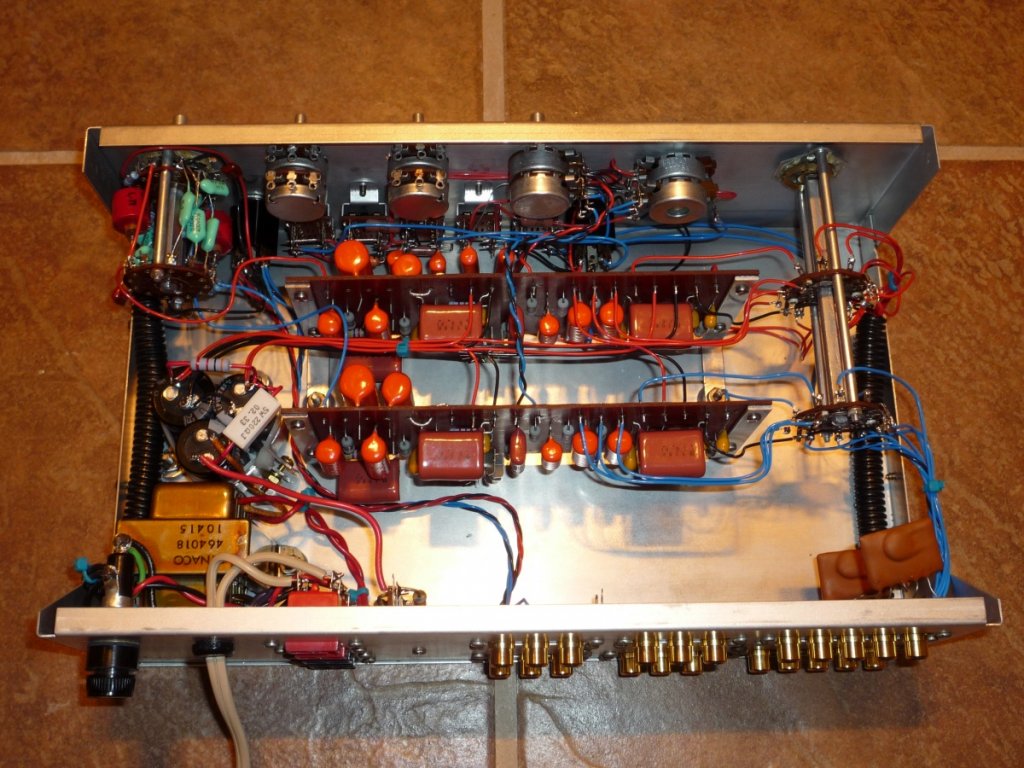

 Somehow, I can't quite remember, I ended up with a pair of Dynaco PAT-4 preamps. My nephew was getting into vinyl and was running his rig through an old Technics receiver. I bought him a new U-Turn Orbit turntable and gave him an Audio by Van Alstine Insight + 170 power amp. I came across the site Updatemydynaco; https://www.updatemydynaco.com and thought it would be nice to refresh one of the PAT-4 preamps. So I purchased the Blue LED light for power switch, Regulated power supply, Tone Control switch, Distortion Reducer, Phono Preamp Upgrade, and the Line Stage Kit. I installed the various kits and listened to the completed preamp and it sounded very good! Much better than the stock PAT-4. I gave it to my nephew and along with the Orbit, AVA Insight+ 170, and a pair of Dennis Murphy's new model Affordable Accuracy Monitors, he had a damn nice system.
After about six months, I upgraded his preamp to an AVA Fet-Valve with Insight + Phono board. The problem now was, what am I going to do with this updated PAT-4? I decided to sell it but felt it wasn't the best it could be. So I went back and purchased the RCA jack set as I didn't want to sell it with the old corroded phenolic jacks. Jacks installed and now the preamp was worthy of inserting into someone's system. But wait, there's more!
I guess I was bitten by the upgrade bug. I then made the final purchase from Updatemydynaco of the Toroid Power Transformer. I also purchased new Alps volume and balance controls. to complete the upgrade I stripped the entire chassis, ultrasonically cleaned the switches, boards, reflowed all solder connections, and rewired the unit with teflon wire. The result is what you see below.
This is probably one of the nicest, cleanest PAT-4 preamps around. I'll be posting this in the Trading Post for sale.

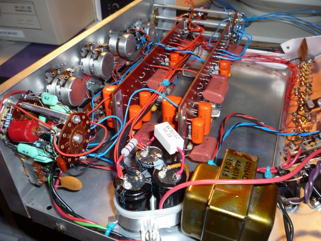

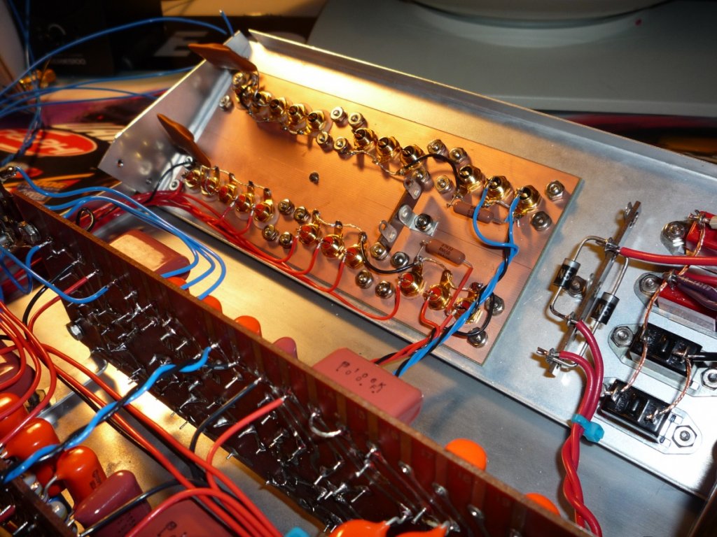

So I've completed the build of the second PAT-4.  Here are some photos:
New rocker switch pcb. Eliminates the messy inter-switch wiring.
New rocker switch pcb installed.
Interior view from front. Note new ground plane I/O jack set PCB.
Interior view from rear.
This preamp sounds very good with great separation, great dynamics, and very musical. But of course I'm biased.  :D Certainly much better than any standard PAT-4 out there.
I'll shoot more photos of the front with the modified faceplate and new power cord installed soon. Also need to sand and repaint the top cover. Will photograph that when complete as well.
One of the consequences of ordering new PCBs is that there is a minimum quantity of five pieces. So I have enough to build four more preamps.
I'm wondering if there would be any interest in the next four rebuilds. If so you would need to supply your own PAT-4 preamp. Now I know its hard to tell how it sounds from my description, so I am willing to send this out "On Tour" for those who would like to listen in their own environment. I would imagine you would listen for no more than two weeks and then send it on to the next participant. Seems to be plenty of PAT-4's out there, so it seems a shame to not upgrade them. Makes a fine preamp for a second system or that budding audiophile.
Let me know what you think.
Ron
