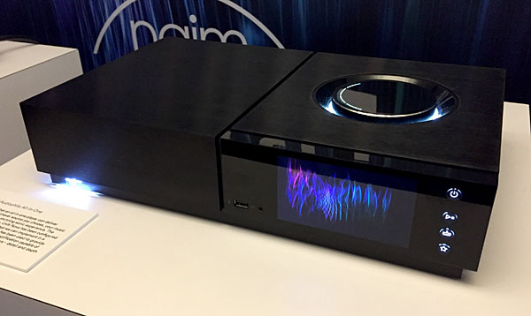

The Unity Nova is an all-in-one receiver.
The March 2018 Stereophile magazine has a great review, now out on your newsstand.
https://www.naimaudio.com/product/uniti-nova
Watch the video:
https://youtu.be/1YuVX9nPl0E
There are more affordable Unity models too:
https://www.stereophile.com/content/naim-thing-uniti-core-atom-star-and-nova
You know you want one.
