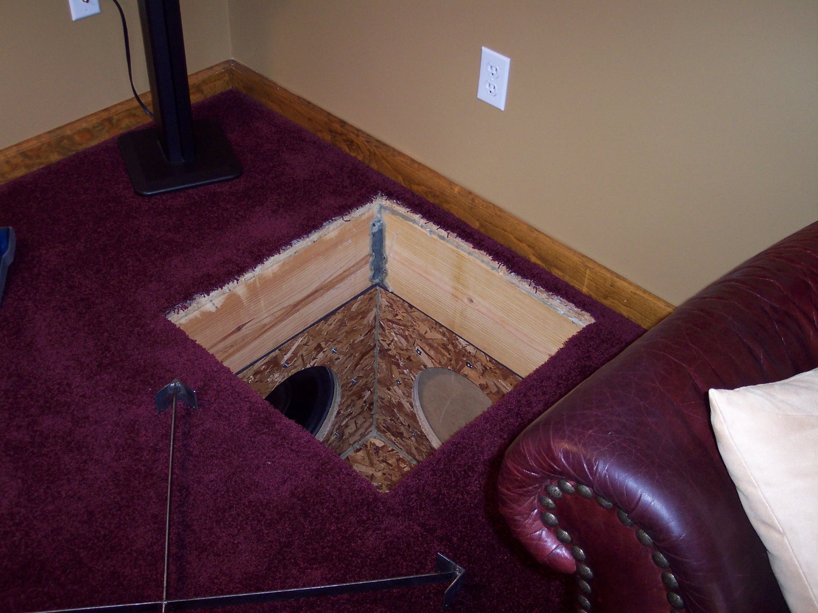

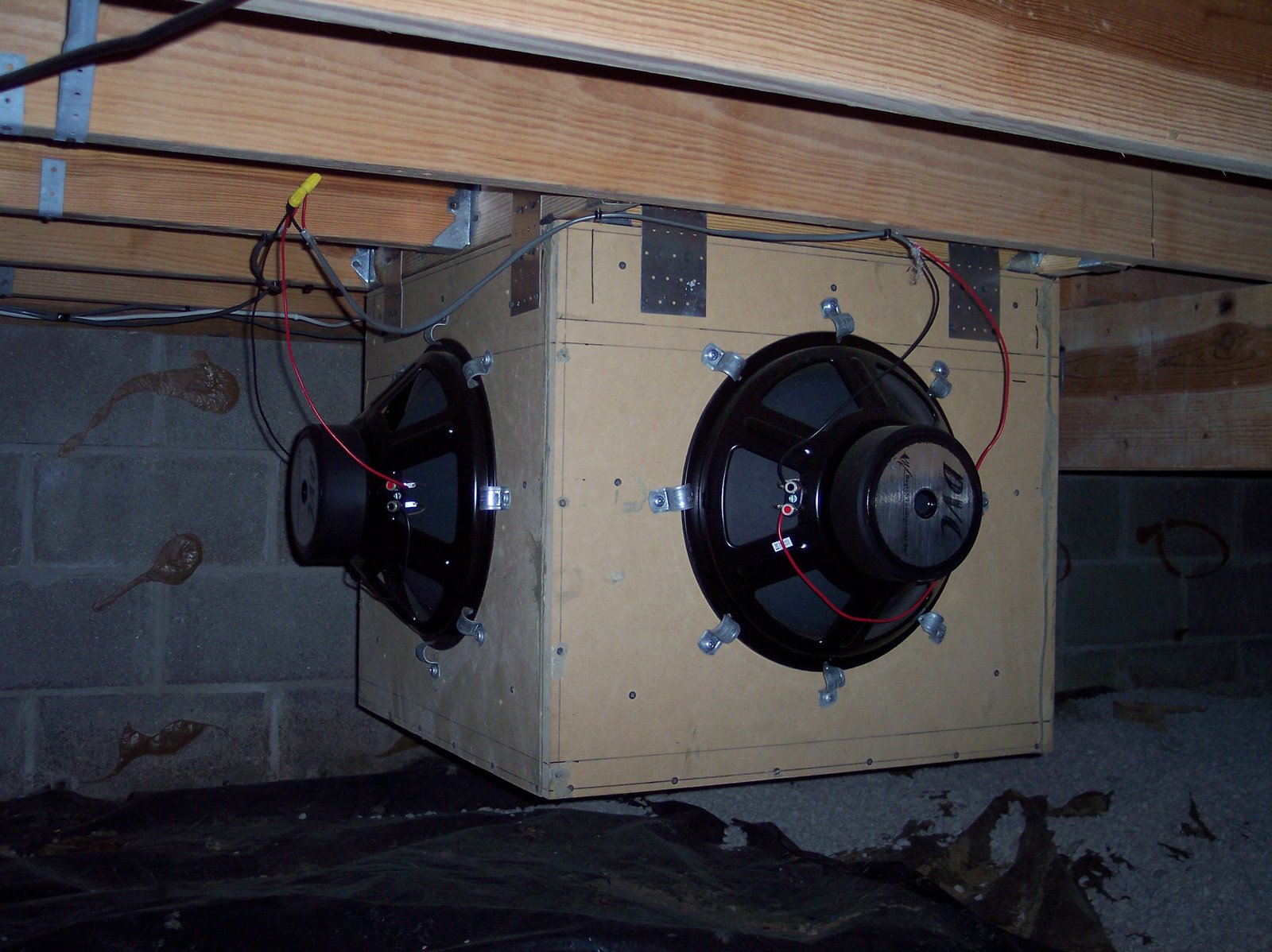

« Reply #15 on: 19 Feb 2018, 12:41 am »
It also says, "4 piece minimum order"
The OP can mount the 4 subs in the basement or crawlspace (if he has one) in an infinite baffle design, hopefully the house is bolted down.
