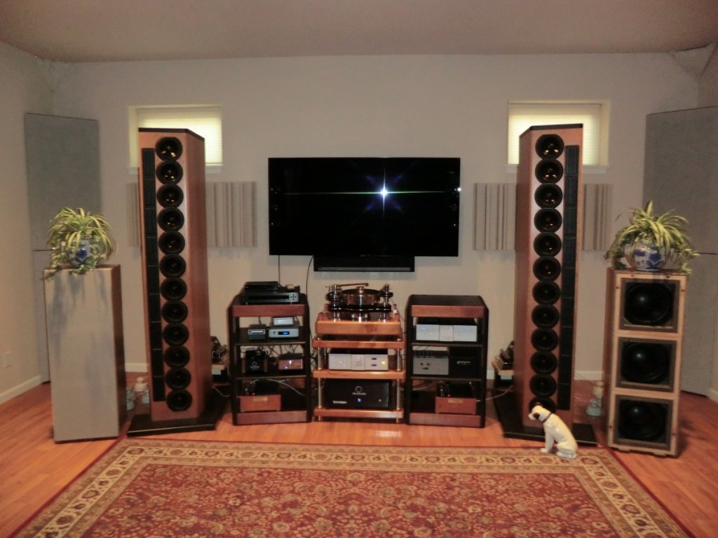

You didn't say whether the sub was to used strictly for HT or whether you wanted it for music as well.
If both, you would do well to pay attention to HAL's thread. Great sound, well thought-out approach.
The Megaliths open baffle line array speakers
http://www.audiocircle.com/index.php?topic=142716.msg1522868#msg1522868
Also, check this one:
GR Research
The quality level of bass reproduction... exceeds any other...at any price.
http://www.audiocircle.com/index.php?topic=155412.msg1666245;topicseen#new
Note that both approaches use the GR Research 12" servo woofers. I have experimented with lots of woofers: everything from small acoustic-suspension AR types to a 24" Hartley mounted in the wall (infinite baffle) and in a 2x2x6' cabinet (transmission line). To my ears, the GR servos have them all beat.
