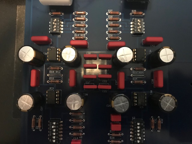

Hi,
I've just bought the Suspiro from Klaus along with the Hana SL cartridge and need some advice on setup.
The Hana SL manual says that the impedance of the cartridge is between 130 and 1k Ohm and recommends a setting of > 400Ohm.  Given this, I have set the impedance of the Suspiro at 1K Ohm and switched ON for jumper number 5 at S1 and S2.  Just wanted to confirm this is correct and that I did not need to also switch ON any other jumper for S1 and S2.
For reference the other jumper switches are:
Position 1 = 100pf
Position 2 = 250pf
Position 3 = 50 Ohms
Position 4 = 100 Ohms
Position 5 = 1K Ohm
Position 6 = 47L Ohm
Thanks

Hey Charles,
As I also have a Hana,  I did set up the Suspiro for you "native", meaning s1 and s6 on...this sounds the best by far with the Hana...go back to these settings,  but then again,  it's very easy for you to experiment with the different settings....

Re: Odyssey Suspiro Setup Question
« Reply #3 on: 20 Jan 2018, 01:58 am »
I have the suspiro SE kismet, S1 & S6 on, 3 gain ON with the Hana and it sounds best to my ears.
