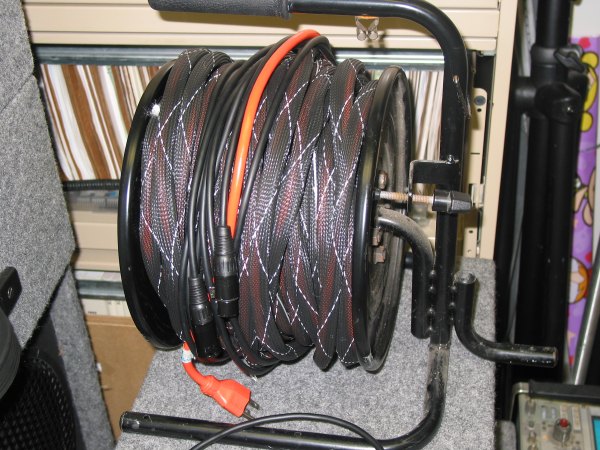

With good AC power cabling and good interconnect cables, power interference is less of a problem than many think. 3 inches of separation is all that is often needed. Now light dimmers and creative power wiring can be a different matter.
In fact, one of our members (who is a day job expert with wire & cable) does some weekend DJ work. He tapes the long AC power and the interconnect cables together on a big reel.
