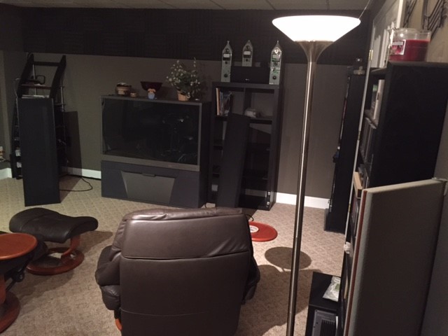

GregDunn
  • Posts: 14
Re: Subwoofer with Magnepan 1.6 speakers
« Reply #12 on: 15 Jan 2018, 11:51 pm »
I have REW and a nice calibrated mic - and have been getting a LOT of experience in measurement lately.   :icon_lol:  But yes - a second sub is budgeted, and will probably fill in some of the holes.  I'm impressed that just this one unit helped a great deal, due to placing it where REW's room simulator recommended.  That's the goal, though.
I noticed that the Dayton is capable of every bit as much output below 20 Hz as the premium subs, and the built-in parametric EQs give you a ton of flexibility in mating it to the room.  That plus the variable phase, crossover and room gain controls, makes it a very powerful setup.  The tech support people are good to deal with, too, which is always a plus.
Getting rid of that first reflection from the walls made a huge difference too; even though I carefully angled the panels, the dispersion is still wide enough at mid frequencies to cause some of the sound to reflect to my listening position. I hung some acoustic absorbing cloth at the points where the sound would bounce off the walls line-of-sight, and elimination of those extra reflections made a useful improvement in the sound.  It doesn't seem as congested or "loud" in the mids, probably because the impulse response at the listening position isn't muddied by the extra "source".
