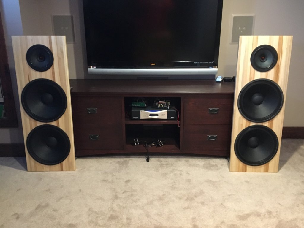

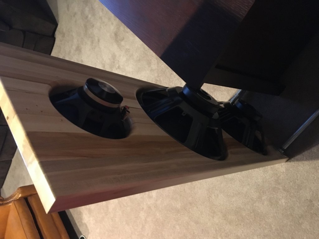

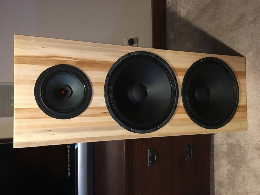

Over the holiday I need to put to use leftover parts as I had sold everything off and no one wanted this stuff.  I glued some added maple to a empty baffle I had to make it 18 inches across, left the 8 inch hole at top, cut two 14 inch holes for the bass drivers, drilled a galvanized pipe footer to each bottom section and stuck a piece on one ft pipe in for feet.  Total cost today from parts express $400 dollars plus some sub amps if you want them.  There are always improvements to each driver or baffle wings etc, I threw it together so I didn’t feel guilty about parts laying around.

richidoo
They look very pretty, and nice woodworking job jparkhur.
I bet it's a nice full sound. Active xo?

DeeAlfred
They look great! What wood did you use for the Baffle?
I would have suggestet rearmounting the drivers. Think it yould have made them look a little smaller.
Nice Job!
jparkhur
Maple..  I mounted back so I did not have to cut hole perfect.   My last ones mounted from rear..
