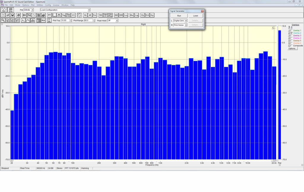

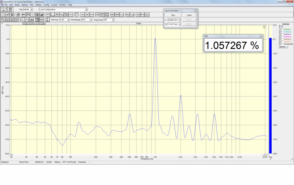

EMIMENS ALPHA-15,  BEYMA, HEIL AMT

To receive a normal bass, two Alfy15 are necessary. Then we will receive 93db on 40gts!
