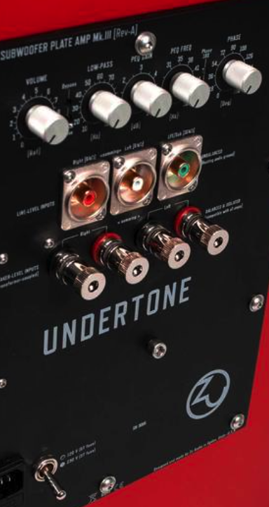

thanks for the help. I am confused by all the options these days:
1 mono LFE vs Hi Level Inputs vs Low Level Inputs vs Summing L/R channels, etc
I am interested in this sub: the Zu Audio Undertone subwoofer http://www.zuaudio.com/subs/undertone.
It does say there is a Signal Processing Bypass, but I dont know how it works.
here is a pic of the backside, and connections options:
From Zu's website:
 "Line-Level Input: yes, RCA (left and right summing)
Sub Line-Level Input: yes, RCA
Speaker-Level Input: yes, 5-way binding posts (L/R summing)
Tunability: yes, very
Signal Processing Bypass: yes, switched for those that want to integrate more elaborate signal processing but desire to take advantage of the excellent amplification of Undertone."
Also: from Zu website, "It is a down-firing subwoofer with active signal processing and built in amplification. It accepts line-level feeds (RCA left and right summing), sub feed (RCA) and speaker-level (five-way binding posts, left and right transformer isolated and summing)."
I couldn't find a better image online that this one:

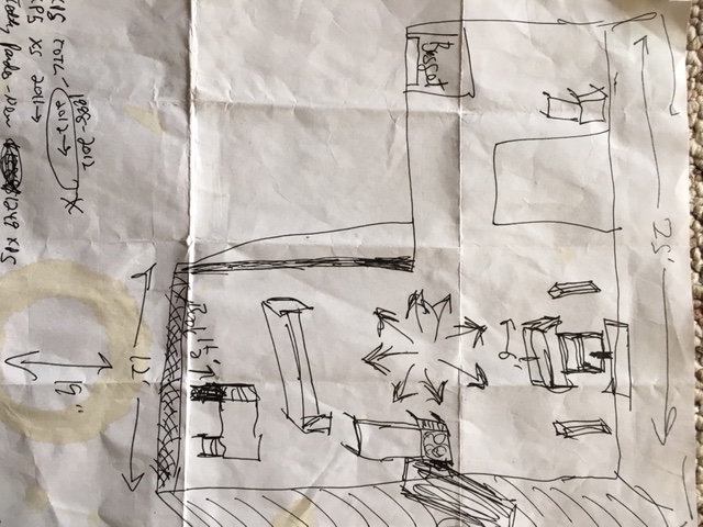

Thx Jack. I recently downloaded an App called AudioTools. A friend from the audio club recommended it.
It is actually pretty sophisticated and offers more advanced analysis. It is modular, so you buy the initial App, then can pay more for apps with the App.
It was expensive as far as Apps go, $20, but I've only paid for 2-3 apps my whole life. I just needed something to get me going. And this is my passion, so $20 well spent.
My room is about 12 feet by 19 feet, and is "L" shaped. So that the side that is 12 feet actually extends to 25 feet into my bedroom from my listening room. Attached is a crappy home made drawing.
Note: the image is stuck sideways, so you have to turn your head to the right!! sorry
