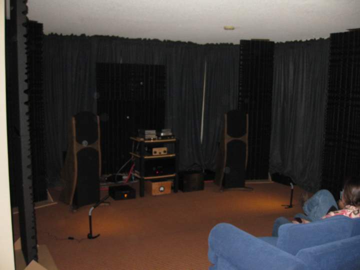

Here is a quick picture of my listening space.
ebag4
Re: Better imaging
« Reply #13 on: 5 Nov 2017, 07:37 am »
That's a nice dedicated listening space Ben.
The equipment rack between the speakers is high enough it is likely not doing you any favors in the imaging department.  If your cables will allow it, I would try pulling your speakers out further into the space first to see what effect that has, another few feet if possible.  This may give you a better feel for what your equipment can do in the room, if it is positive but you want to move the speakers back closer to what they are currently, you can start adding room treatments to the front wall.  Playing with the speaker distance to listening position may reap benefits as well.
Something else I found that helped in ways that I didn't anticipate was measuring the room response to get the servo subs set more optimally. Doing this balanced out the system and had a positive impact across the board in my experience.  It may not impact imaging, but the end result surprised me in the overall balance of the system, not just in the lower frequencies.
I see no reason you shouldn't  get great sound in that space, it will take some trial and error as well as some form of room treatment.

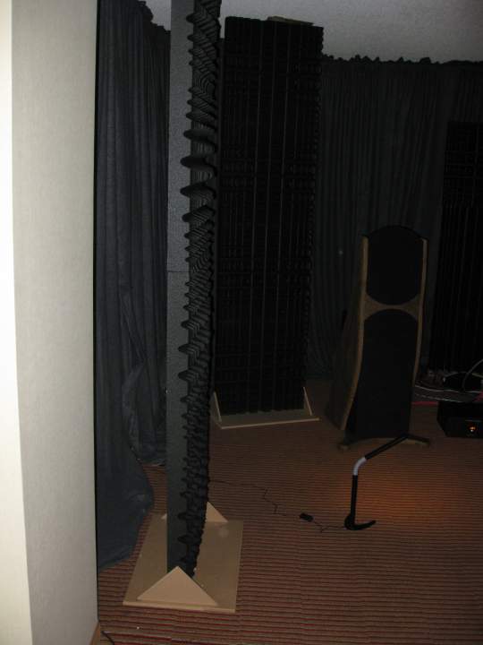

I would suggest some room treatments on the side walls at the first reflection points as a minimum. You are likely losing some focus due to this.
Not a great photo. but gives you some sense of what they had in place at RMAF.
The panels at the side wall first reflection point.
