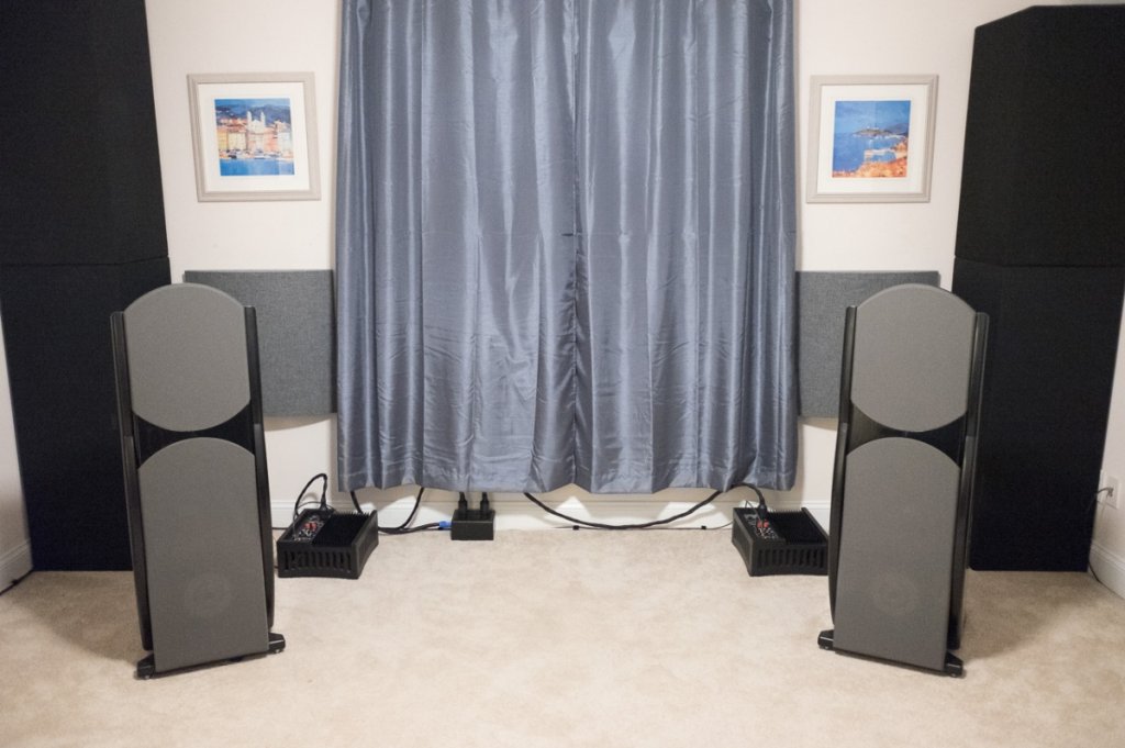

Experimenting with running my equipment rack on the side of the Super Vs to keep the source equipment out from between the speakers. Unfortunately, I am dealing with some pretty bad foot-fall issues with my new suspended turntable, and mounting the rack to the side of the speakers works better, plus it opens up the option for wall-mounting the turntable should it come to that.
My question is, does anyone see any downsides to running a pair of line-level RCAs for the sub amps and speaker cables for the co-axs of the Super Vs in a techflex sleeve together to minimize the cabling clutter? I want to run the bundle along the baseboards, behind my corner bass traps and to the two speakers.
My plan is to still plug in the two sub amps to my P.I. Audio Mini Buss, but move my integrated tube amp (Decware, shown in the picture below) to the rack on the side, for easier volume control and also to attach my two sources to the inputs of the amp (DAC/turntable).
Suspended flooring in my listening room is causing me a whole bunch of angst...
Wall mounting the turntable between the speakers is out of the question due to a large window between the speakers.

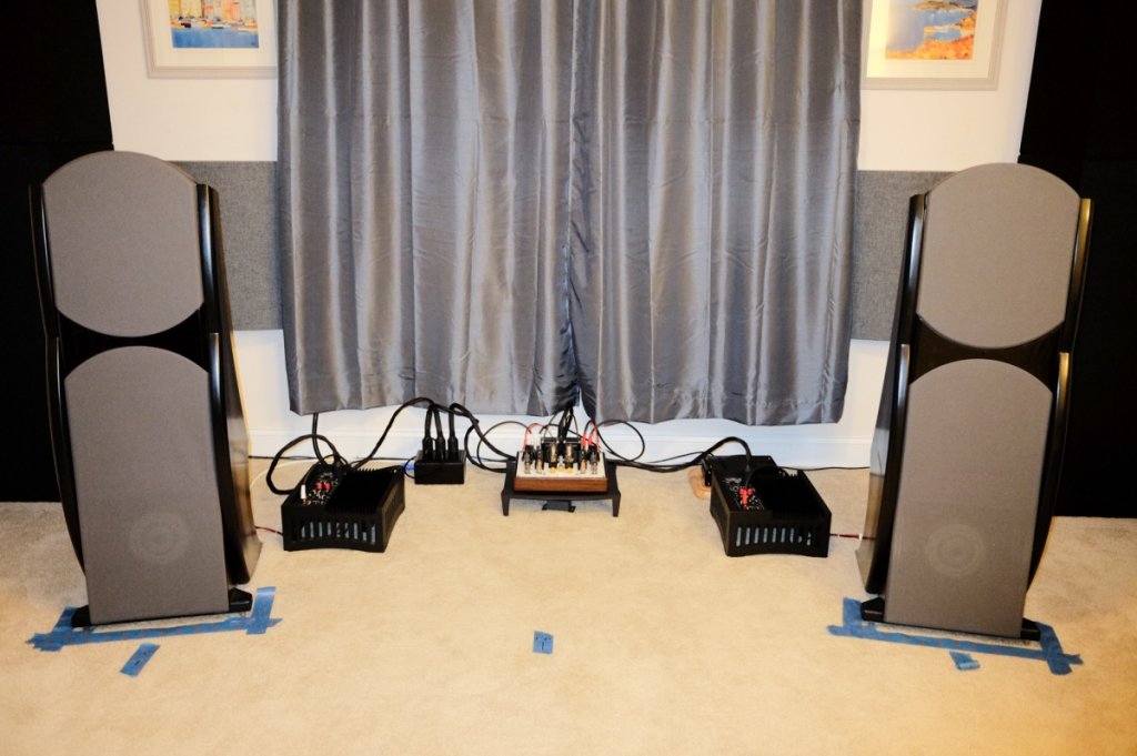

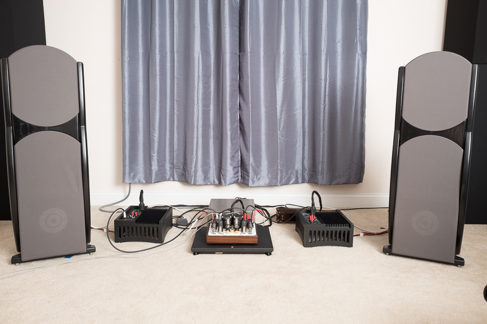

Here you can see the current setup. I am planning on moving the Decware amp over to the side rack, and also moving the BPT 2.5+ (seen in back of first picture) to my source rack:

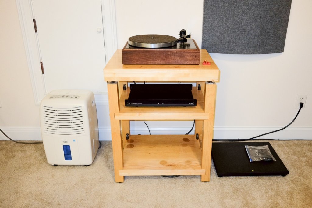

New maple rack, which I got to deal with the footfall issues of the AR-XA TT. Nice rack, not helpful at all between the Vs in my room. You can see the cheap 10' interconnects that I have wired up temporarily to experiment.
« Last Edit: 3 Oct 2017, 08:25 pm by danvprod »

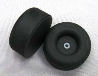

Herbies Big Fat Dots under the speakers solved the same problem for me.
My turntable is on a maple rack between the speakers. The Herbies took care
of about 80% of the problem with my  Project TT and then I bought a VPI TT
and have had zero problems with it.
Major improvements in overall sound too, especially with imaging and soundstage.

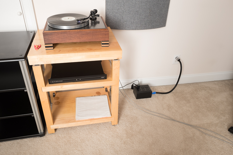

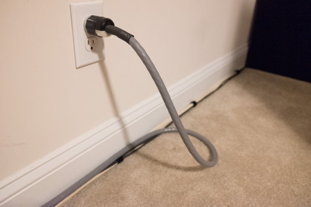

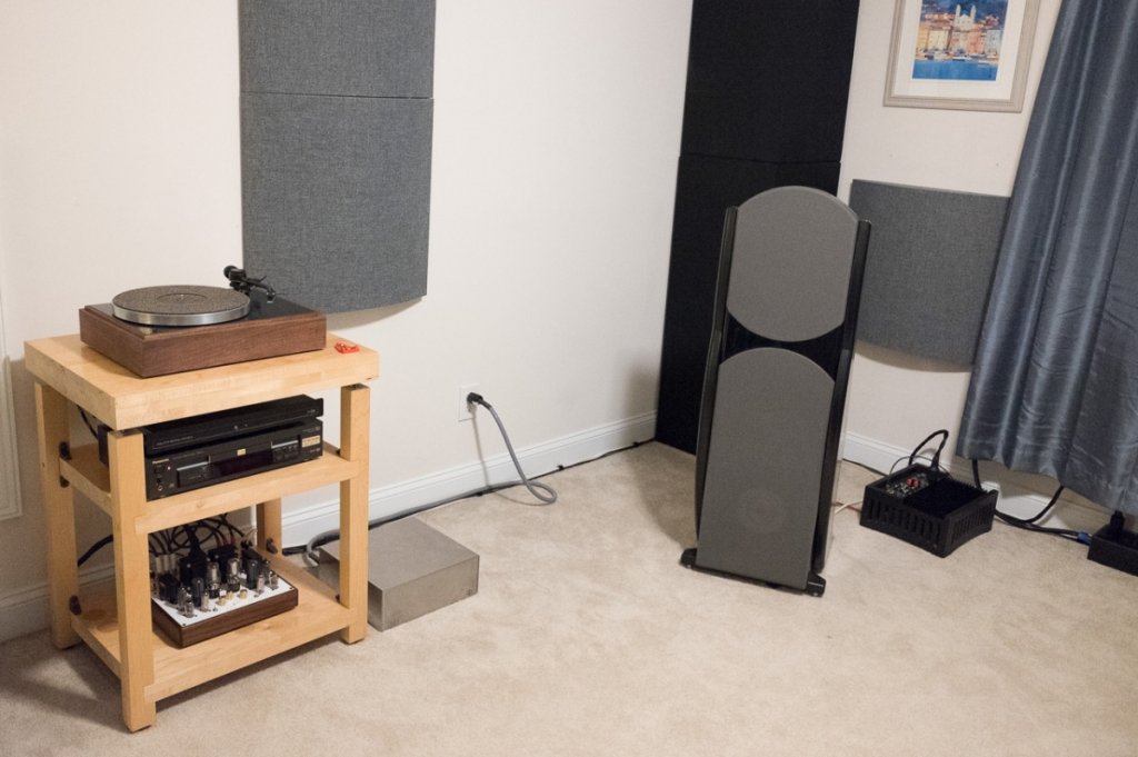

Here is how the rack looks. You can see how the speaker cables and ICs follow the baseboard now:
Detail:
How the GR Super Vs look now with nothing in between them:

I would keep power cords away from your interconnects.  If you really want to run them along the walls then try to separate them by an inch or two.

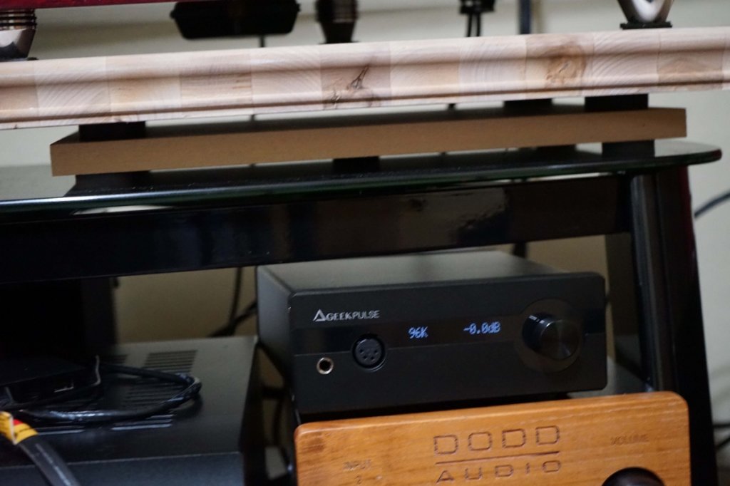

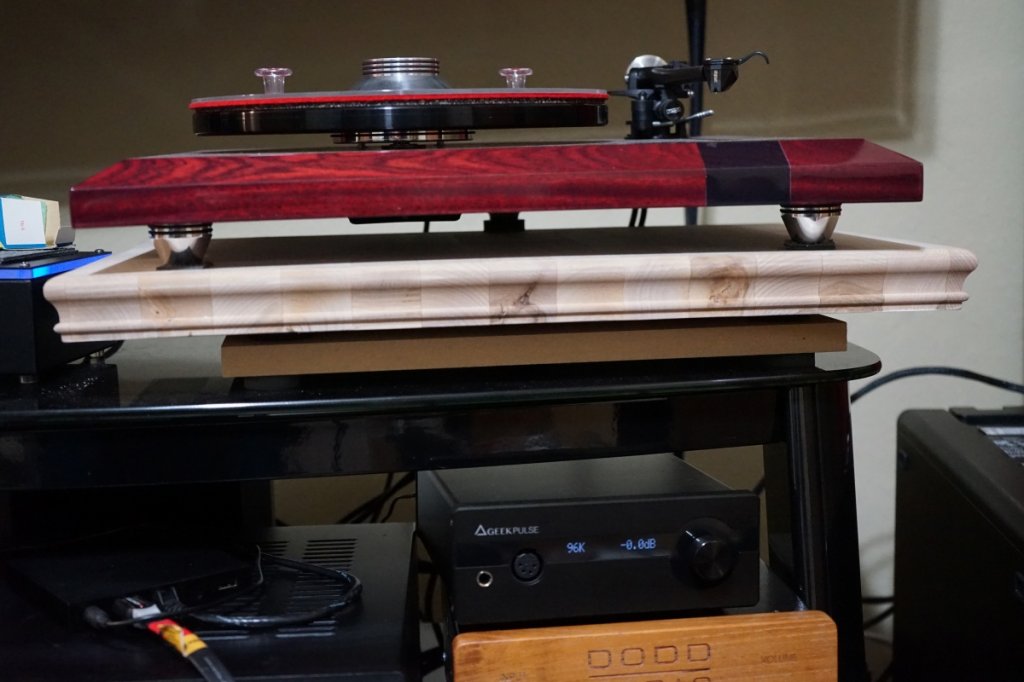

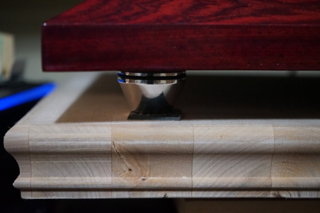

I put together an isolation system for my TT that works really well. It consists of two platforms and three layers of isolation footers. The isoation footers are a combination of Herbie's Big Fat Dots and Decoupling Footers from George Merril.
Decoupling Footers  -  http://www.hifigem.com/60-durometer-feet.html
Big Fat Dots - http://herbiesaudiolab.net/spkrfeet.htm#bigfat
The current set up has Big Fat Dots on top of the equipment rack,
A piece of 3/4" MDF on top of the Fat Dots,
Decoupling Footers on top of the MDF,
A piece of a birch workbench top on the footers,
More fat dots / NoRez damping layer on top of the birch platform,
And the TT on top of that. I needed thinner pieces for the front feet to level the TT.
How well does this work? When I was setting it up I had the equipment rack pulled out from the wall (on magic sliders). Once I had the isolation set up I played a record to see if the things that used to make the arm skip, walking close to the rack, touching another piece of equipment in the rack, etc. was fixed or not. Yep, they were fixed, none of that made the tonearm skip.
Since I was satisfied, I was ready to push the rack back into position. Only thing was I forgot to stop the record first. I just pushed the rack back and it kept on playing without a hitch, No skip, scratch or anything.
Won't try that again, but at least I know my isolation efforts worked. Adding the second isolation platform is what made the difference.
danvprod
@mlundy57 -- thanks for the detailed response here, definitely something to consider.
I'm back to the original setup, which sounds quite a bit better to my ears to the two alternatives (rack in middle, and all gear to side).
1. Sold the BPT 2.5 PC, and am back to just the P.I. Audio MiniBuss.
2. Amp is now in the center between the speakers, with my better supra ply speaker cables (short runs connecting the co-axial drivers).
3. Turntable and phono preamp is still on my side rack, since that is the only way I can play records without it skipping. I may still consider the wall mount and sell the rack.

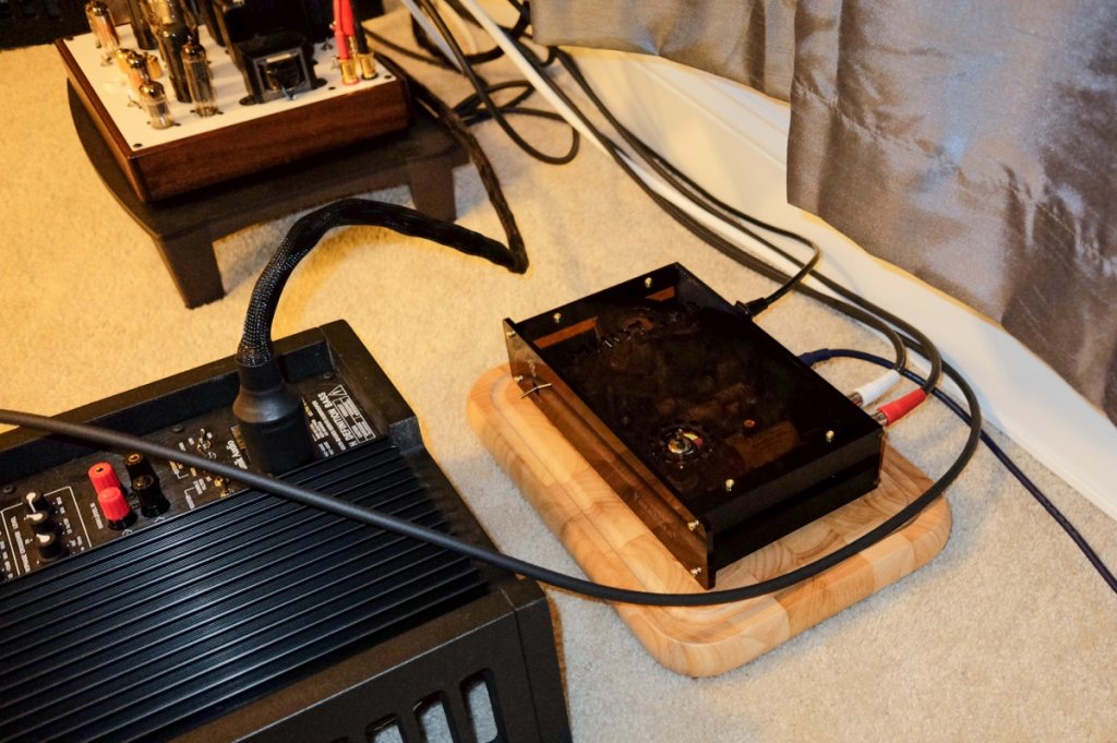

4. DAC is behind the right sub amp connected to my mac for digital audio playback. DAC is now on cutting board.
I still have to do some cable organization work to try and keep some of the power cables away from the signal cables. And I have to get another TWL digital american PC for my DAC, although I have been considering the OPPO sonica DAC, since I can put all my FLAC files on a 1TB drive plugged into the OPPO and not have to deal with the long S/PDIF cable and USB to S/PDIF convertor out of my Mac. It also opens me up for high res playback.
The only compromise I can see right now is needing to run 22' RCAs from my phono preamp to my amp. But its a RG6U solid copper double-shielded cable and I can seem to hear any additional noise vs. the shorter BJC I was previously using.
I also played with carefully placing the speakers and toeing them in so they are firing exactly at the same angle behind my head. I've moved the speakers in about 3" and toed them out by a few degrees. I also moved them out into the room another 2" or so. I'm now at 83% width center to center vs. speaker to listening position. \
Here is the turntable and phono preamp.
