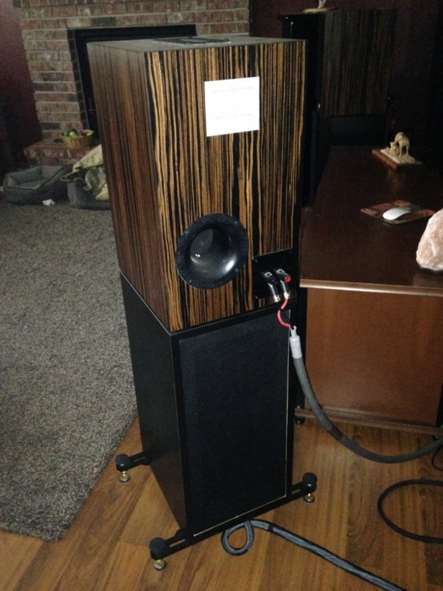

Long time lurker on AudioCircle.  However, I have recently obtained a completely custom Omega that I thought I would post some pictures and give some high praise.
So hopefully I do this correctly as I have not posted any pictures in this forum in the past.
This project has been a long undertaking and it required the services of several other AudioCircle companies.  Obviously I need to thank Louis, but I also need a lot of credit and thanks to Dave at Zenwave Audio and Danny with GR Research.
Being a silly person who thinks they can do it all I "tried" to build my own speaker.  While my creation using some GR Research speakers and other components we good.  It was not capturing me the way I felt it should.  So I decided to go a different route.  So, based on the extremely high recommendation that Decware posted I did some research into the Omega speakers and decided to see if Louis would do some custom work for me.  He agreed and off we went.
So what Louis and I started with was an RS5 based High Output monitor.  I asked if Louis could incorporate some RAAL tweeters I had from my own built speaker and we decided to mount them up-firing.  I had recently purchased some Zenwave interconnect cables (which are freaking great) and wanted to get as much Zenwave into my system as possible.  So I had Dave and Louis connect and they worked out how much Zenwave to use as the harness for the internal speaker wire.  That is the Red wire hanging out of the driver opening.  The binding posts on the back are also from Zenwave.  I had Dave ship to Louis some Furutech binding posts.
Hopefully, this posts correctly as I have more to share.  In the end I am so pleased with how things have worked out and want everyone to see the fantastic work Louis did on a very unusual build.

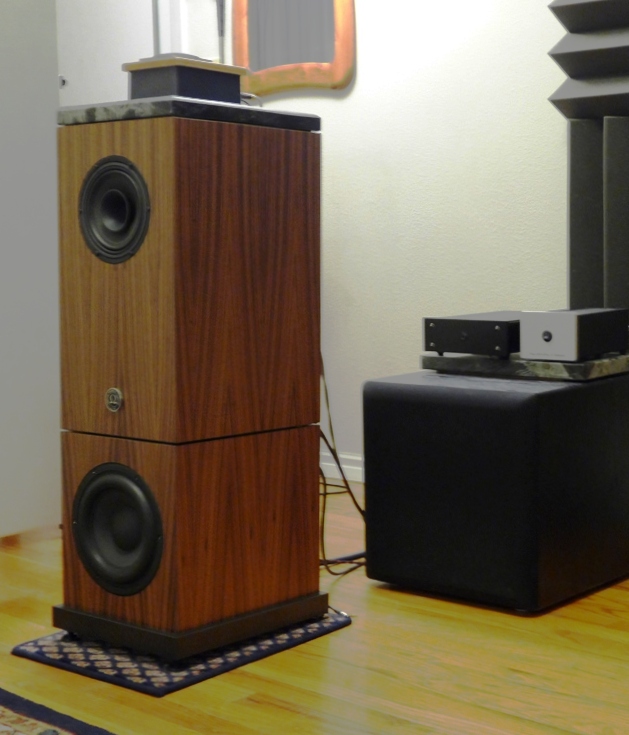

The custom stuff is fascinating.  I love what Louis can do.  He did a nice integration job for me with SAM's and Rythmik 8" woofers and plate amp in his cabinet:
I also have powered tweeters (SB Acoustics Satori beryllium dome) pointed upwards.  Powered by a Bantam Gold amp.  Simple first order high pass using a capacitor inside the tweeter box sitting on top.  I will assume your ribbon tweeter takes its signal from the main amp with a similar high pass that doesn't affect the main drivers (other than having the tweeters in parallel), yes?
Louis advised me the same about having the tweeters pointed up.  Adds high frequency "air" without significantly affecting the virtues of the single point source and its imaging.

So now some of the real custom stuff Louis did for me.  As I mentioned I had some GR Research speakers.  These were incorporated into a OB sub set up. I wanted to keep these as the OB subs are so good.  I decided that I would have Louis build me some custom cabinets that I could drop the 8 inch servo subs into and then use them as the base for the monitors he built.
I will load up some final pictures of the complete set up and how I integrated the Rhythmic amps probably tomorrow.  Again, the final results I think came out fantastic.

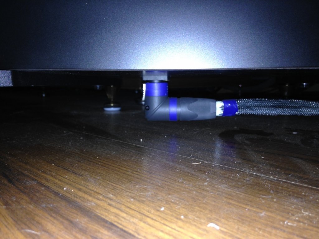

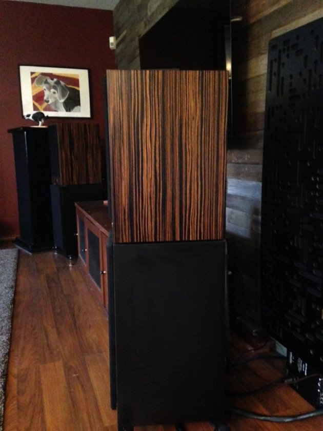

So to explain the lower sub cabinet in a little more detail I need to explain a bit of what I am doing.  My original speakers that I am swapping drivings with was an OB sub that connects to a Rhythmik amp.  So you can either find a way to mount the amp in the sub cabinet or you can create a separate amp box and connect via some wire.  I chose to use a separate amp box and use SpeakOn connectors on both the Amp and Sub end.
It is hard to see, but if you look close at this Sub picture Louis took you can see a hole in the bottom of the Sub.  That is where the SpeakOn mounting connector will go.
I fed the SpeakOn Connector from the Amp using a 45 degree angle connector.  It fits just right as I have lifted the Sub cabinet off the floor using some speaker stand outriggers.
The end result from the back looks like this.  I had Louis create a speaker grill that fits into the back opening of the cabinet.  He added some wood strips (back to the first picture) that you can just push in the grill and it fits flush to the opening.
Here is an image with the back grill cover removed.  I added some NoRez that I got from GR Research to help reduce cabinet resonances.
So what I ultimately ended with was this:
In a bit I will get more into how this set up sounds.  But I will just leave a short description; Awesome.

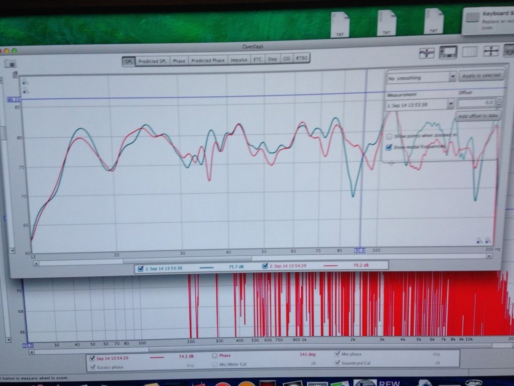

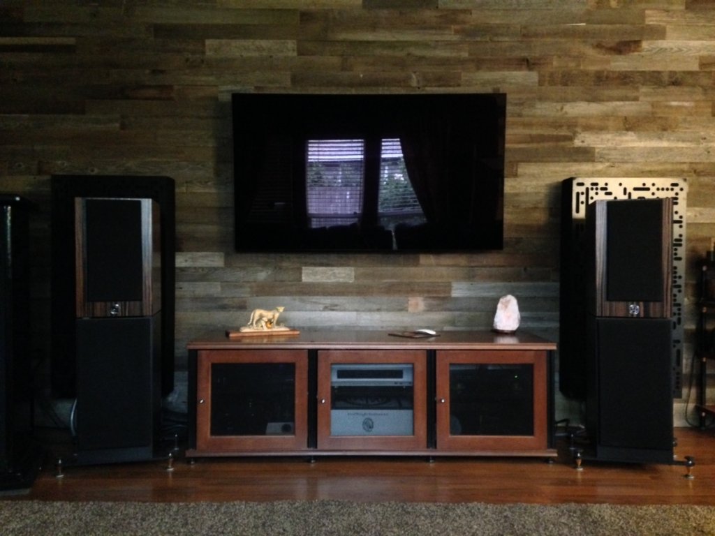

As to performance.  I think most everyone who follows this circle has heard a large number of reviews of the RS5 based HO speakers.  This version is a bit different in that Louis widened the front baffle to 14 inches to match the bottom cabinet he was building for the 8 inch dual woofers.  So stacking the monitors on the sub cabinets provides a symmetrical look and stability.
I mentioned I use a lot of AudioCircle companies.  Between the monitor and Sub cabinets I am using Herbie Audio Labs Von Schweikert Special fat dots for module decoupling.  This uses four Big Fat Dots plus one Square Fat Dots per speaker.  They have some tackiness without being messy that keep the monitors very secure and appear to work well in decoupling the cabinets.
Behind the speakers are some GIK Alpha 6 bass panels with some diffraction plates.  I wanted to try and control some of the back wall influence - especially since the subs of open baffle.

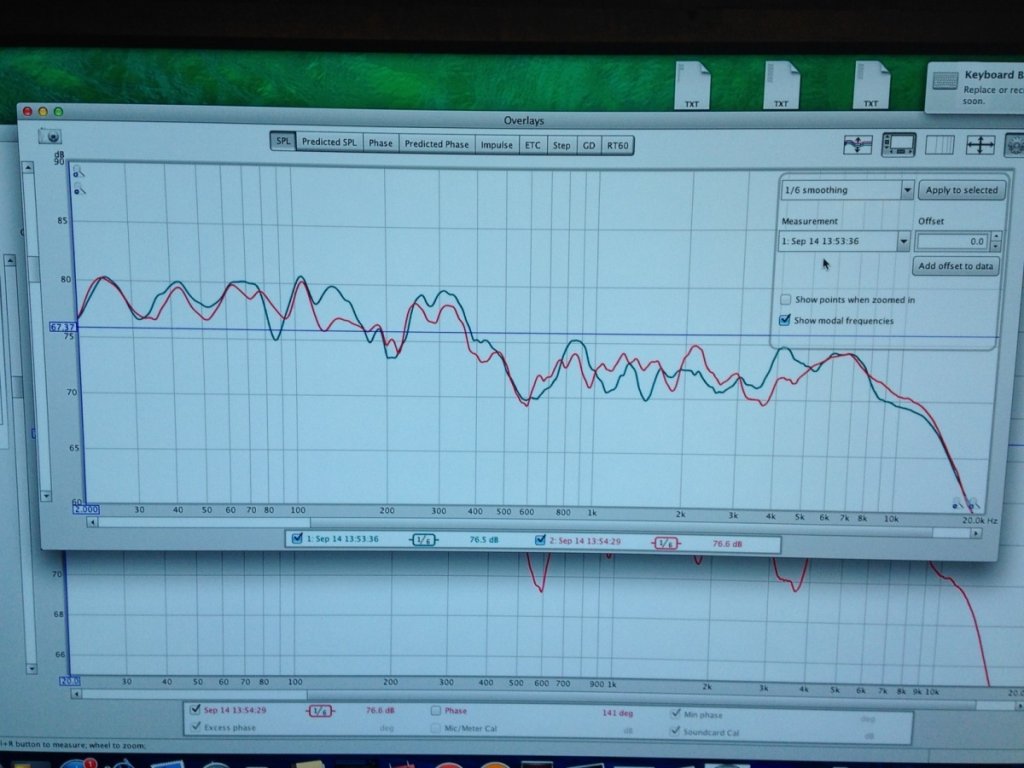

As a mentioned earlier, for the bass I feed a signal into a Mini DSP 4x10 that controls level, crossover and room correction.  The Omega Monitors receive a direct RCA from a Decware Super Zen Triode so I am not altering the signal to the monitors at all.
After running many REW test signals I finally ended up here:
This is the Left/Right channel overlaid on each other.  As mentioned earlier I like a house curve and I have purposely tipped the bass region up about 5 db.  That is why between 20 - 200 the measured SPL is around 82 and 200 and above is around 77 db.
For just the bass region here is a view with no smoothing (sorry this picture is a bit blurry):
This resulting response in this image was helped out quite a bit by the GIK bass panels as there were a number of rather large dips most likely being generated by the back wall interference/cancellation.

The final thoughts I want to convey is these speakers are also fantastic in a home theather set up.  I have removed my center channel speaker and run Phantom and this set up works great.  Some may scoff but unless you are way off center you do not lose anything.  Now, add the subs into the equation you are get bliss.  I find movie theather soundtrack playback to be horrid when you go to the theather.  Way too loud and way to much bass (at least way too much muddy bass).  It hurts my hearing.  At home the explosive soundtracks do not hurt my hearing and with how fast the bass is now the reproduction of loud events have a more viseral feeling.  I can play very loud (even with a 2 watt SET amp) and the Omega's do not strain.  Every thing is crystal clear and the impact is crazy.
An example of this was the last couple episodes of Game of Thrones.  When the zombie bear atacked in episode 6 it was so freaking real sounding and litterly had me jump out of my seat.  In episode 7, when the Night King took down the wall with the zombie dragon the impact was amazing.  So much good bass and extension.  The Omega's never strained and the bass was better than anything I have ever heard.
Now I do have to add that I have another OB Sub (triple 12's from GR Research)  that adds the very bottom end so I am sure that plays a factor, but in total, this set up is everthing I have ever wanted and Louis' work helping me with this experience has resulted is something amazing (to me).
