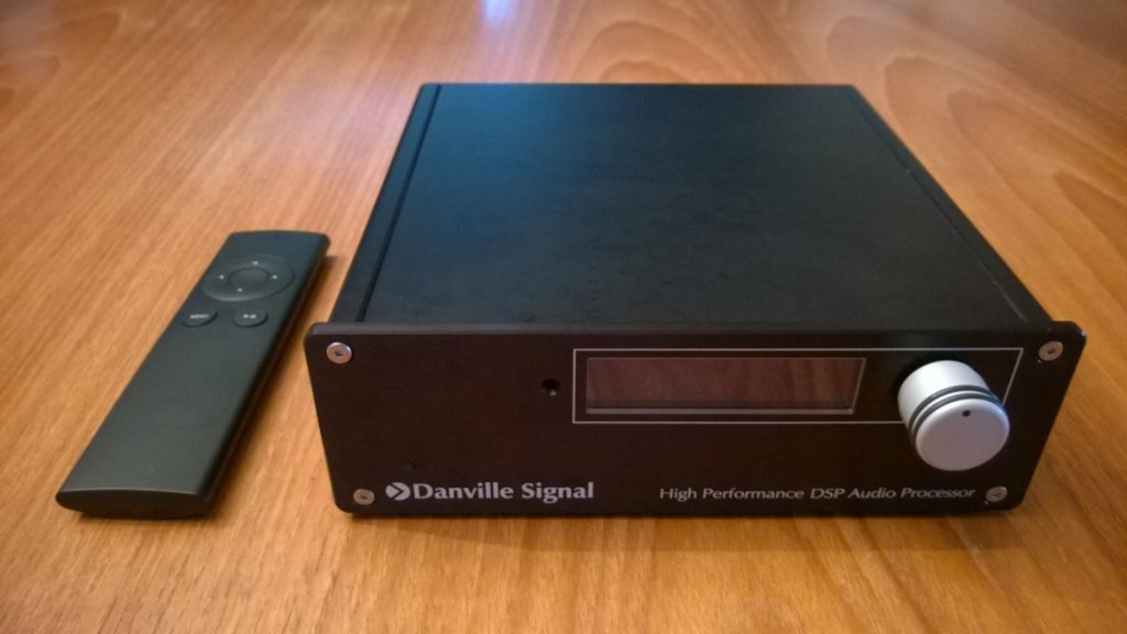

Received the first batch of the new High Performance DSP Audio Processors with LCD display and remote control system.   New DSP Concepts Audio Weaver software version dedicated to this hardware is installed on a HAL MS-3 Music Server for trials with The Megalith speakers.
Have translated the original Megalith crossover into the latest AWE system and have it running for listening trials.  Initial trials with my headphone setup were excellent as a HiRez PCM DAC, iFI iCans and HiFiMan HE500 phones with the MS-3 as the music source.
The components of the system are the dspMusik RevD motherboard, uC and LCD display for both front panel control or IR remote control with the included unit.
This unit is now a HAL system as it is customized for my customers use with the DSP Crossover developed for their system.
The front panel control or remote control allows the user to control 8 channel DAC volume, mute, input selection, ADC filter select, DAC filter select, ADC input range control, DAC output range control.  This gives a more optimal input and output voltage range depending on attached system needs.
Please contact me for further information.

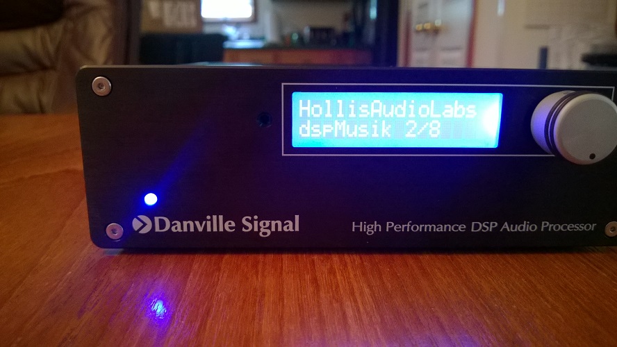

Getting ready to ship a dspMusikLCD to dpd as an update to his RevD system.  New firmware and LCD display compared to his RevD for use with the updated version of Audio Weaver.
The updated Audio Weaver program has a new user interface and improved high performance Linkwitz-Riley and Butterworth filters that can now be used in block diagrams for crossovers.
Have also updated the ACA LS-9 crossover and VMPS RM50 crossover block diagrams for use with the dspMusikLCD for other customers to try.  The VMPS RM40 crossover will be updated as well for trials.
Will soon be testing the dspMusikLCD updated crossover for The Megaliths since the update is complete.  This should be interesting!
