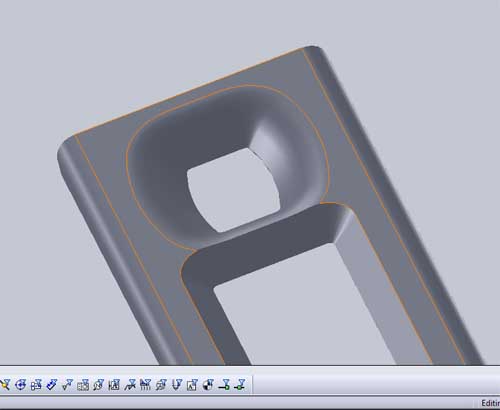

I'm going to follow up that last post with a Super-7 baffle update.
Here are the old baffles.
The wave guide for the tweeter had to jot out from the baffle to create a smooth tweeter response. The Neo 10's were also flush mounted from the front.
The new baffles allowed all the drivers to be rear mounted and was to do away with the wave guide for the tweeter sticking out there.
See new baffle pics:
The Neo 10's loved the new mounting. The response was un-effected by the rear mounting and was smooth as glass.
The tweeters though.... Agh.
So I blocked off the Neo 10 holes with card board and the lower ones with a block of Stryofoam.
Now check this out.
The green line is the tweeter response with the cardboard over the upper Neo 10 holes and the Styrofoam over the lower ones. Looks great huh!
The purple line is with all four drivers blocked off with card board.
And the red line is with the Neo 10's mounted. Dang it! Picky little drivers...
The tweeters response does not like the in and out reflections of the Neo 10's inset from the rear mounting.
We could front mount the Neo 10's, but then they won't be aligned front to back. It will change the driver offset. I don't like that idea. Or we can go back to the more complex original baffle design. Or something.... I am still thinking on that one.
Danny Richie
Re: New GR Neo 3 tweeters are here.
« Reply #149 on: 8 Jun 2018, 08:59 pm »
Another update...
Jay sent me these baffles.
Then I modified the tweeter wave guide.
And I played with the short side wing a bit.
The response looks excellent.
Here are the measured responses with a second order slope.
And for the first time I was able to use a first order slope with these drivers. I have never been able to do that before.
So lots of promise on this one.
