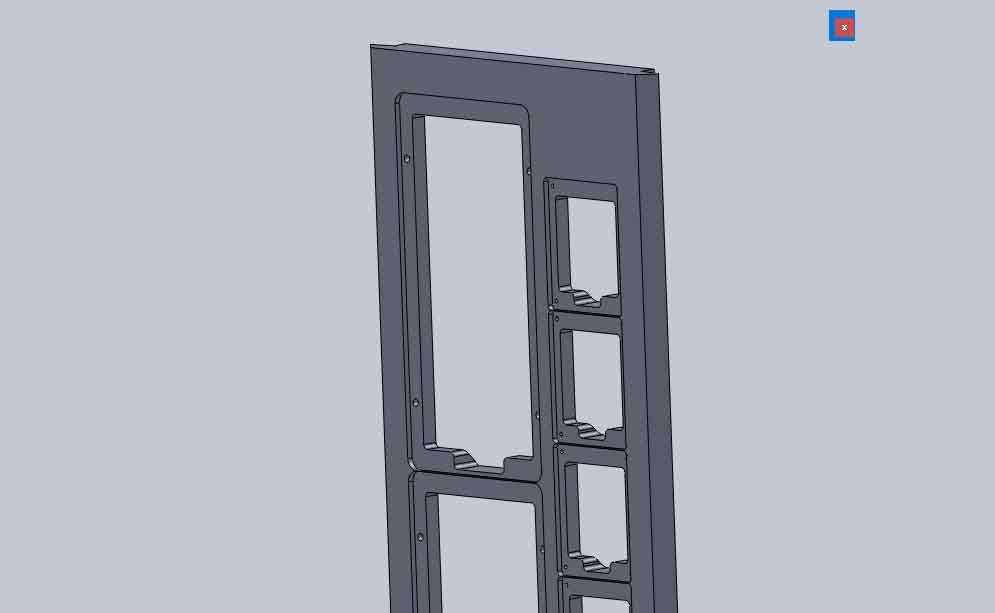

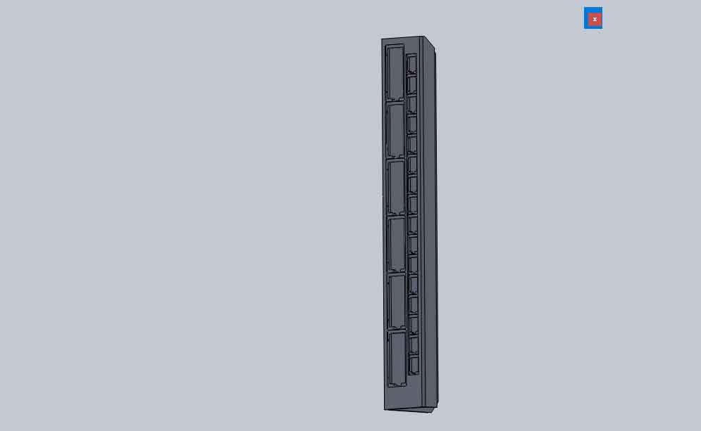

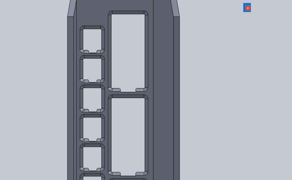

I'm actually  working on this... got side tracked  but had  another person ask  again  yesterday and  got my interest  going  again.  Not looking at  bamboo ,  something  else
I have a  good model  / dxf done up  now,  just  waiting on  a few things.

Considering getting  a prototype done  if there is  interest
jay
I’m interested, might have to sell an organ or two (or some of my audio gear) to afford the drivers but ...
