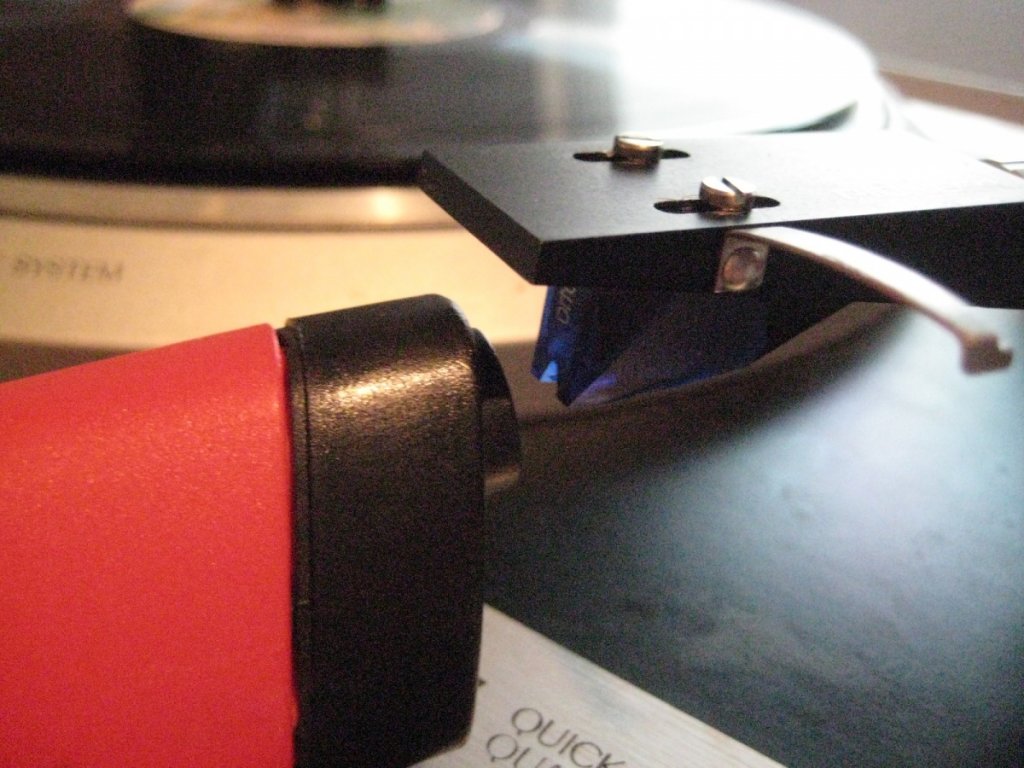

My system, especially my turntable, suffers from static buildup not only in the winter months but in the summer as well.
When my LP’s start sounding distorted I’m pretty sure it’s from static build up.
I wash and clean the LP’s and then zap them with my ZeroStat.
But still sometimes it sounds distorted.
:idea:
What if I Zapped my cartridge.
Hmm, who knows, I’ll either fry my system or it'll help.
Here goes:
All components on, preamp in mute (down 20db) I’m gonna try it, shit.
It’s definitely doing something. Even with the preamp in mute I hear popping sounds coming from the loudspeakers.
Holy crap :wtf:.
Flip the mute switch to off, set the stylus on the LP.
I’ll be damn, no distortion.
It worked.
:thumb:

That's really high risk approach, putting between 10-100 thousand volts around the coils is asking for electrons to go where they aren't supposed to.  If you think it's static electricity, then it can only build up on non conductors... the vinyl, the cartridge body, record mat, and I can't think of anywhere else.  The Zerostat ionizes the air, creating free ions that can be attracted to opposites and neutralize them.  Use it a few inches away from the cartridge, but not close enough to actually jump a spark to it and let the ions do their job.
Or take a mister and moisturize the air around your turntable.  The moisture can also dissipate static build up.
I can't remember who it was, but someone at AC overloaded his phono pre from touching his tone arm after walking across carpet in a dry room... spark jumped from him to the tone arm and into the electronics.

All you need to do is touch R output center to L output ground for 20 seconds then switch. That should do the trick.
I doubt what you are doing is really bad, but probably not as effective.
I've done that as well but only after shutting down everything and disconnecting the turntable from the phono stage.
I should make a habit of doing that every day.
I tried the zerostat while still powered up (dumb as is was) so I wouldn't have to shut everything down.
It worked but sure did scare the crap out of me even with the preamp in mute.
I've alway's wondered if my zerostat really does anything and after trying this experiment I can definitely say my zerostat is working.
I can't recommend anyone trying what I did without caution.
