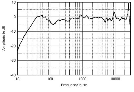

As an aside, I do recall way back when that the NHT 3.3 was shaped as it was to create a "corner" for the side mounted 1259 woofer in order to minimize the SBIR/Allison effect as much as possible. That being said there is still that "dip" :
https://www.stereophile.com/images/archivesart/N33fig2.jpg
I find that I have to be careful with interpreting the measurements from Sphile and the NRC. The NRC is anechoic so you won't see the effect. With Stereophile I look and see if it was an in room or quasi anechoic measurement. With the in room measurement I can trust if the loudspeaker design minimizes the SBIR effect intrinsically or does not (as long as it was setup right and there aren't large absorbers in the setup). With the quasi anechoic I may not see it at all but it still might be there.
