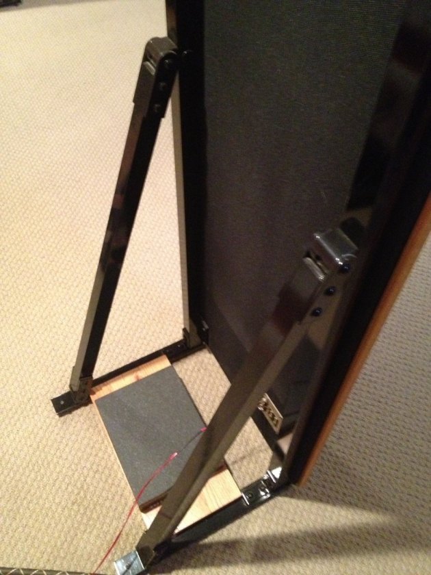

In my experience: suspended floor = isolate (decouple) gear with moving parts (speakers, TT's & CDP's) from the vibrating floor.
                                     slab floor = anchor (couple) gear to floor with solid frames, brass spikes and mass.
My photo illustrates the coupling to a carpeted, basement floor... solid frames bracing the panels. Adjustable, brass spikes to get through the carpet.  And last, added mass for a more solid stance.
-Dieter
