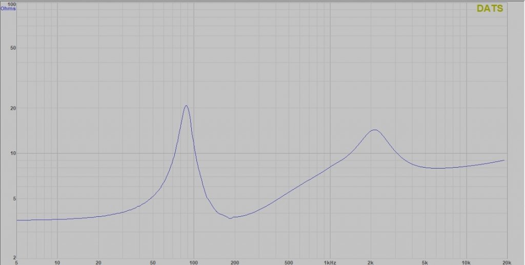

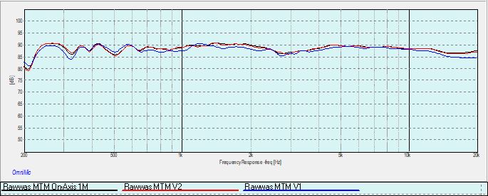

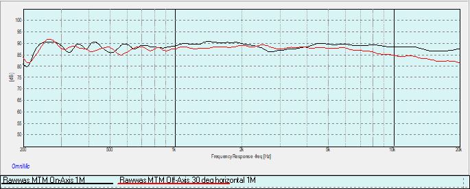

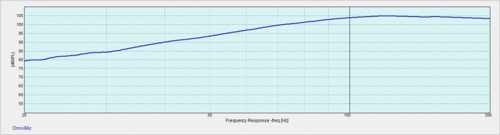

Here are the measurement graphs. 1/12 octave smoothing but no gating so there are some effects from the room.  Gating makes everything above the frequency look more pretty but you lose the low frequency resolution. The nearfield bass curve is more anechoic and minimizes the room effects to show the true bass extension.
With 92dB sensitivity the 4 ohm (nominal) and 3.6 (minimum) impedance isn't difficult to drive.  Very smooth response curves, both horizontally and vertically. The 200-250hz dip is the floor bounce (reflection) that's typical of a stand-mounted speaker. The vertical curves were taken on-axis with the tweeter, midpoint of the tweeter and upper midbass, and on-axis with the lower woofer.  Uniform vertical behavior with a MTM using midbass drivers this size isn't easy to achieve!
