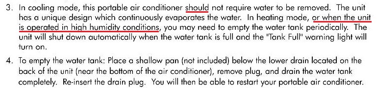

For this particular model (Haier HPN12XCM), an excerpt from the manual:
Not sure how removing moisture from the room air then letting it evaporate back out into the air does anything to control humidity ( :scratch: ), but in any case for almost all of the portable AC units, if the water tank becomes full the unit will shut down and either a warning light or a code on a display will signal the tank needs to be emptied, preventing overflow and room damage.

Cold air hitting warm air equals condensation which is why most of these units have a water reservoir.
The unit that is described above sounds more like an evaporative cooler or possibly the scenario of running in a very dry climate.
