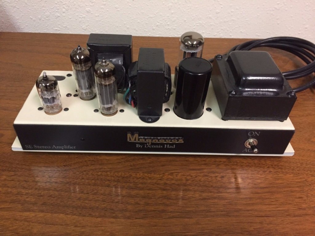

« Reply #9 on: 18 Jun 2017, 11:46 am »
I'm really impressed with the Dennis Had Magnavox single ended EL-84. Dennis Had, retired founder of Cary Audio and chief engineer, totally ungraded this vintage amp with all new parts and an improved circuit using a 7308 rather than a 12ax7. One of the sweetest toned amps I've owned and a great match for my Zenith 49CZ802 open baffles.

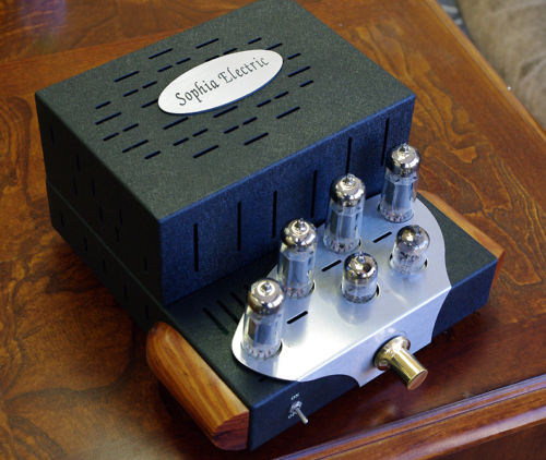

« Reply #17 on: 4 Dec 2017, 09:21 pm »
I am an early adopter of M2s and run mine with a Sophia Electric Baby tube amp.  You can routinely find these for sale used on Audiogon, I got mine locally for $600.  IMO you would have to spend upwards of $2k to improve on this amp, beautiful to look and lucid sound.
