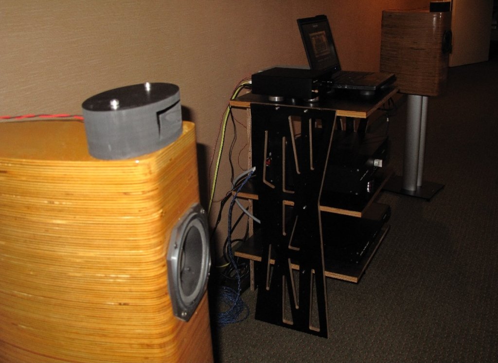

I will post my opinion/experiences in favor of super tweeters. The executive summary is I like ‘em.
I am a speaker agnostic, or you might say slut. By that I mean my experience is there are multiple paths to musical HiFi bliss in your listening space. I enjoy and cycle through the following speaker types:
  • Single driver “full range” monitors especially the Fostex FE103 and FA120
  • Full range electrostats, just finished a few months with my Stax ESL-F81s in the system
  • Bi-amplified mini-monitors (with and without subwoofers)
  • Bi-amplified monitors (with and without subwoofers) including configurations using Fostex, Radian, or Accuton drivers.
  • Large format classic JBLs, Bozak, Altec, and Hartleys (hints on sneaking the 15” coaxs back into the living room without the wife noticing are always welcomed)
During my most intense period of Fostex FE103 adoration I had an experience where I “saw the light” (heard the sound?). Annually in Bartlesville Oklahoma we have the OK Mozart festival. As has become common in classical music a ‘name’ performer perhaps outside the classical world is included to expand the draw. In 2009 that name was “Chick Corea with his Trio”. On the night of the performance Chick strolled onstage and told us there had been a scheduling problem and his trio became unavailable so he had called an old friend for help. And he introduces Gary Burton. And that is how I spent an evening of pure musical bliss sitting 30 feet from Gary Burton’s vibraphone and the 9’ concert grand Steinway being played by Chick Corea as they performed selections from their classic 1972 fusion jazz album ‘Crystal Silence’. Driving home afterwards I had to admit that as good as the FE103 and FA120 are at high frequency reproduction (and they are quite good) for ultimate fidelity dedicated tweeters and/or super tweeters are needed. A paper cone or dome just cannot get those last overtones of Burton’s hammer hitting the bars of his instrument.
Over the years subsequent experiences especially some design commissions have led me to the belief that the ‘super-tweeter’ range 15k to 30k Hz is very beneficial when we are chasing that ‘ultimate’ HiFi facsimile of live reproduction experience. I have witnessed the ‘turning on the super-tweeter makes the bass better’ experience. Which I freely admit is weird and essentially the definition of counter intuitive. And getting the off path weird unconventional beliefs on the table I believe even listeners who no longer hear pure tones in the 15k to 20k audible ranges react positively to systems that do not cut off at 20k. Not weird but rather “it is what it is” comes from watching the spectrum analysis display on Adobe Audition show content above 20k Hz as I master my 96k/24 bit recordings. Violins and percussion seem especially prone to go above 20k.
Here are a couple of reasonably priced drivers you can experiment with that have useable output above 20k to 30k Hz.
  • SEAS Prestige 22TAF/G (H1283) Alum/Magn. Alloy 22 mm Dome Tweeter
  • Dayton Audio AMT Mini-8 Air Motion Transformer Tweeter Part# 275-095
Speaking (again) of 20k when computing the crossovers for a super-tweeter experiment do not be afraid to try crossover frequency values like 15k or 20k. Remember there is output below the corner frequency of a filter, if it’s a simple series blocking cap 1st order filter its significant output. We want to blend the super-tweeter in with your existing system.
Here is my FA120 speaker with Dayton AMT super-tweeter at LSAF 2016.
