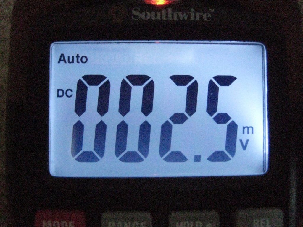

Since I’m planning on several Felix conditioner builds and also while I've been reading about how to build DC blockers, and if I really need them, I did an
experiment to try and measure DC Offset on some of my 1980’s equipment.
Not owning an oscilloscope I’m trying to measure with a DMM.
If the procedure below isn’t correct please chime in.
Equipment:
Pioneer SA 8500-MK2 integrated amp.
2-Adcom GFA-555mk1 amps.
Procedure:
With everything disconnected from the equipment, volume at zero, balance control at center, all filter switches off on the integrated amp,
Power up all equipment for 15 minutes.
DMM set to DC millivolts, Auto measuring, and I also measured manually.
All readings were taken from the loudspeaker binding post outputs on each component.

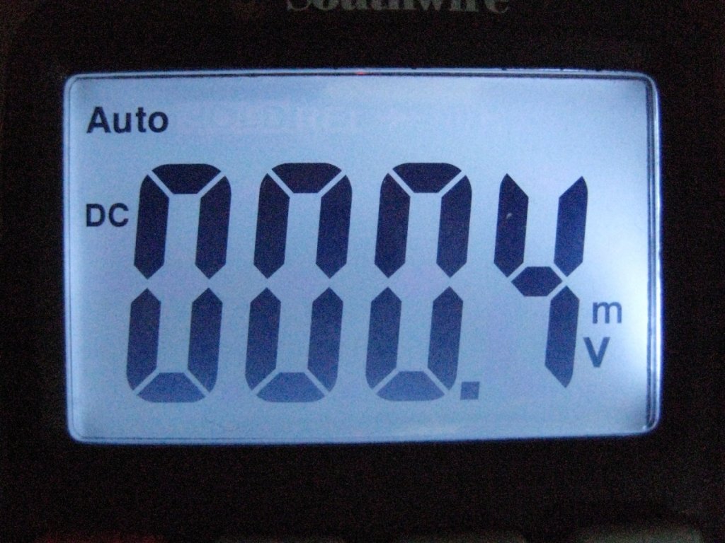

Pioneer SA 8500 MK2 integrated amp:
Left Ch:   000.4mv
Right Ch: 002.5mv

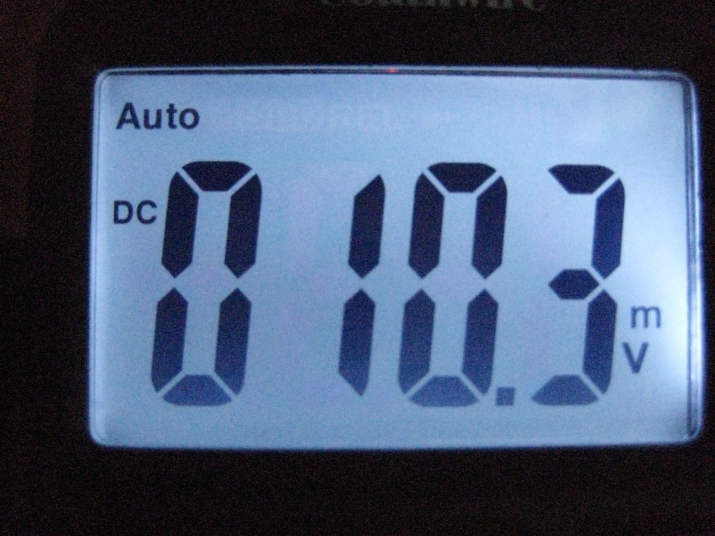

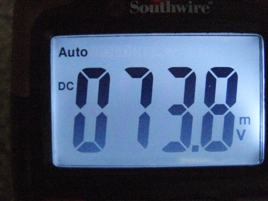

Adcom GFA-555mk1 amp:
Left Ch:   010.3mv
Right Ch: 073.8mv

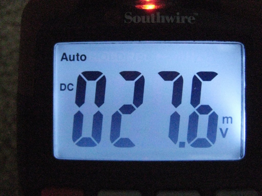

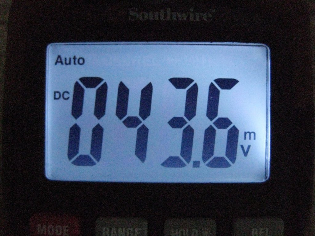

2nd Adcom GFA-555mk1 amp:
Left Ch:   043.6mv
Right Ch: 027.6mv
If I did this correctly, it looks like the measurements are low and these components don't need a DC blocker.
I’d still like to know how to build a DC blocker, some of my other components may benefit from one with a Felix.
Thanks to Anand, TomS, Richidoo, Occam, and everyone involved with the “MANY” Felix threads on AC.
Steve.

*Scotty*
Re: Felix conditioners and DC blockers.
« Reply #3 on: 4 Jun 2017, 07:14 pm »
If the amplifiers were thoroughly warmed up and had reached their normal operating temperature then it looks like you are good to go. Cold amplifiers generally have more DC offset until they warm up.
Scotty
WireNut
« Reply #4 on: 4 Jun 2017, 08:01 pm »
Scotty
They were  :thumb:. I had them powered up for at least 15 minutes before testing.
Thanks Scotty.
*Scotty*
« Reply #5 on: 4 Jun 2017, 10:59 pm »
You might have measured lower DC offset if the amps had a half hour to cook, all of the semi-conducters in the circuit have to reach thermal equilibrium before you will see the lowest DC offset. It is also critical for the differential input pair to thermally track one another or you will have higher DC offset as well as drift over time.
 In any case your numbers look good enough.
 Scotty

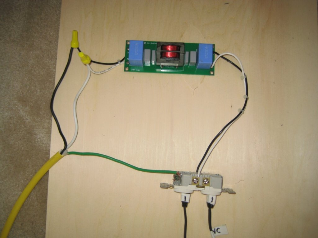

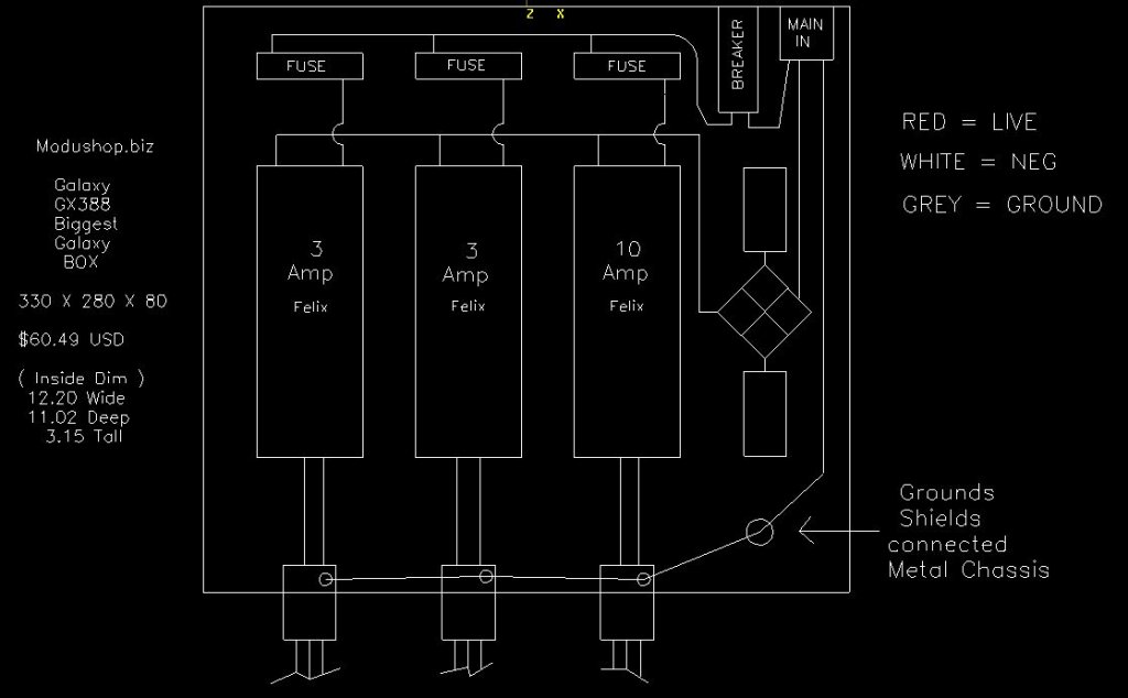

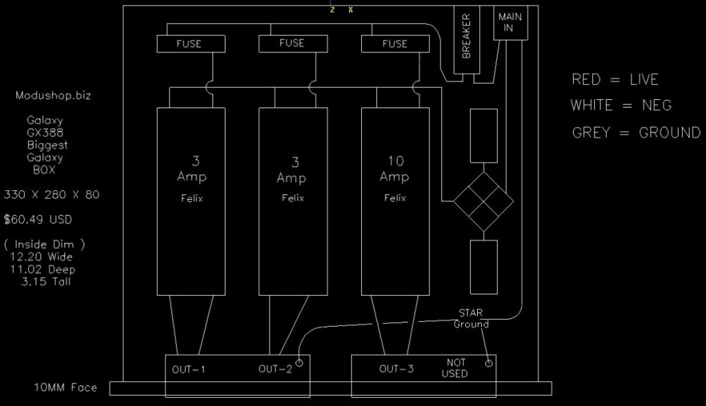

Lots of time on my hands being recently retired to learn and experiment.
After cutting grass today and killing weeds I sat down and drew this up.
Take a look at my wiring. I see one thing I don't like and could use AC's input.
Notice the ground conductor. I'm using 2 receptacles with the tabs broken.
Since im going to break the tab between out-1 and out-2 the ground conductor for out-1 is not directly connected to mains earth.
How can I fix this?
The fourth output will not be used.
The case is all aluminum, electrically conductive.
This is a learning process for me, be gentle.  :|
Here's my cad drawing.
Damn, It's to dark, Gotta do it in all white.
« Last Edit: 29 Jun 2017, 11:39 pm by WireNut »
Speedskater
  • Posts: 2758
  • Kevin
« Reply #14 on: 30 Jun 2017, 06:30 pm »
If I were to build 3 Felix's (which right now I'm not) I would place each in it's own box with a very short cord to the hi-fi component (maybe a captive cord with IEC connector). The longer the cord from filter to component the poorer the filtering.
The best filters are attached to the component chassis, but in the real world that's hard to do.
WireNut
« Reply #15 on: 1 Jul 2017, 12:53 pm »
I wanted to build each Felix in it's own box but ruled it out due to cost having several Felix's projects to build. No room to build them and the blockers into the components.
One other thing Im wondering about is since I use bulk power cable with 3 wires + shield + drain wire Im not sure how Im going to hook up the shield/drain.
Connect the ground and shield drain wire to the case and receptacles or let it float.
Speedskater
  • Posts: 2758
  • Kevin
« Reply #16 on: 1 Jul 2017, 01:40 pm »
Does the filter chassis have input & output receptacles or captive cords?
Either way, the Safety Ground/Protective Earth is required to be connected to the filter chassis.
I would connect all the shields & drains to the filter chassis, where each cord enters the chassis.
At the distant end of each cord, I would let the shield & drain float.
WireNut
« Reply #17 on: 1 Jul 2017, 04:59 pm »
Hi Speedskater,
I think I’ll remove the output receptacles shown in the Felix pic above and just use bulk Belden power cable #19364 for the in/out.
This way will remove several connections.
The 19364 cable is a 3 wire cord with shield and drain wire.
Below is a draft of the wiring plan.
Outlet from wall:
Male plug, Belden cable, hot, neutral, ground and shield/drain wire connected to the male plug.
Input to Felix / metal case:
1- Belden cable, connect both the ground wire and shield using the shields drain wire to Felix metal chassis.
Outputs:
3 - separate 19364 cables.
From the metal case, connect all ground wires / shield drain wires to chassis.
From there the hot, neutral, ground, shield, and drain wires from 3- Belden cords will pass thru the rear of the Felix case until reaching
the 3- IEC’s ( for components) where the shield and drain wires will be disconnected / floating.
Only the hot, neutral and grounds will be connected at each IEC.
I hope I’ve explained this right and mostly that its correct.
New drawing. Something like this.
« Last Edit: 1 Jul 2017, 06:00 pm by WireNut »
