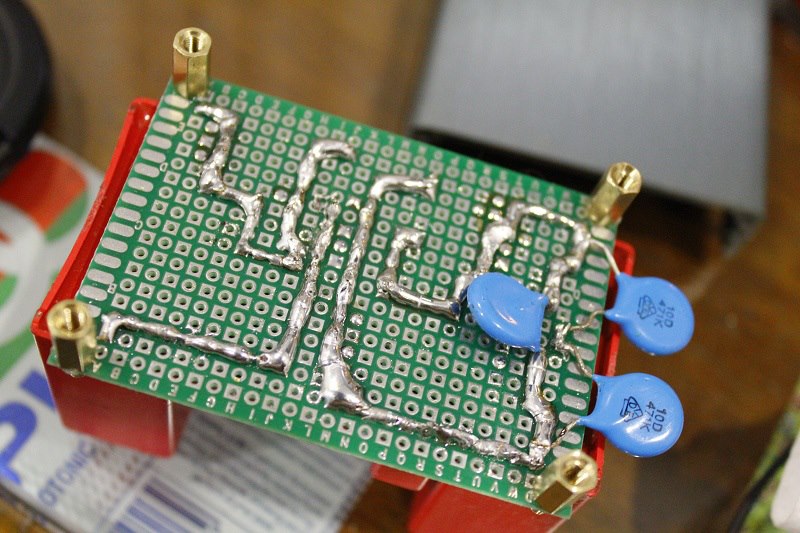

greetings everyone, i have been messing around felix filter for years because it works, proven by my ears A/B comparison since "my first revision"
https://forum.lowyat.net/topic/2687806/all
(mods please remove this link if it's not allowed to do so)
I had zero electrical knowledge from school so I really not sure if I'm doing them right
This is my first revision, that is not CMC so i moved to the second revision
This is my second revision, started to put the filter inside my dac, but...
That was a very bad and dangerous design, I also heard that Y capacitors help in filtering so i added them...
My third revision, removed those Y capacitors to follow the original felix design, with Silver plated OCC wires connected, but its extremely friggle
My fourth revision, put one more CMC since i ordered in bulk, had 10 of them.
this is a very stable revision but it is still placed in a DAC, I had been messing around modding DAC without professional electrical knowledge so I've replaced a lot of parts and burnt a lot of money. I've bought another DAC and decided not to do any modding on it.
I decided to do this, just plug to the AC input of DAC then the current is clean. I have several questions :
1. I've read that more mH of the CMC will do the filtering better, so I placed 2, let them parallel with 20mH each, is my logic correct?
2. Also, will those coilcraft CMC does the job better than mine? I can't find that kind of CMC here.
3. Will adding Y capacitors does the job even better?
4. How much voltage is required for those capacitor? more voltage = better? because smaller voltage will bring closer loop due to their small size, also those capacitors are DC rated. If I decided to make a new ones with shorter closed loop, I can only find 4.7,0.47,0.01 uf here
Thanks
Folsom
Re: Felix project
« Reply #446 on: 8 Oct 2014, 12:32 am »
1. No parallel won't do much. You're better off following the second set of capacitors with a CMC and then adding a third set of capacitors.
2. Coilcraft makes some fine CMC's, ordering direct may be the only way to get them.
3. Yes and no. Don't add Hot to safety ground Y capacitors. You can use very large to small ones from Neutral to safety ground. **Be sure your neutral and hot are not mixed** More capacitance here is preferred, with multiple capacitors. I use large amounts but as Occam has pointed out, precautions need to be taken to insure neutral and hot are not mixed.
4. What's your countries voltage at the wall? Try to go double. 120v, go for 250v+. If you're at 250v you may only be able to get up to 330-400v.
5. YOU NEED TO HAVE PROPER SIZED CMC AND WIRE FOR THE AMPERAGE OF THE LOAD. The CMC should be rated as 2x the amperage of the device plugged into this filter (your DAC it sounds like). DAC = 3A then CMC should be 5-8A area. Do not use a 3A CMC on a 3A load (DAC or whatever). You need to run wire along the whole distance, that tiny silver stuff may not be large enough. The wires that go from one end of the filter, to the CMC, and from the CMC to the other end, need to be properly sized for amperage. Just solder isn't advisable, nor is tinsel sized silver wire. Your power cables are probably 14-10ga, for example. I don't know all the information, I just know I'd want a more robust current capable wire than solder/tiny silver for safety and quality.
6. DAMN dude, you can post pictures here with diagrams or markings, anything, so we can tell you if it's remotely safe. We aren't liable for your home project but we sure as hell don't want you to get hurt. Some members will tell you not to touch it. I'm fairly certain you can learn, but let's help you do it safely.
« Last Edit: 8 Oct 2014, 03:02 pm by Salis Audio »

Occam
Re: Felix project
« Reply #452 on: 8 Oct 2014, 01:58 pm »
3. Yes and no. Don't add Hot to safety ground Y capacitors. You can use very large to small ones from Neutral to safety ground. For example 300-100uf in parallel with a 50-10uf and 1uf-.1uf, will work and doesn't have to be as high of voltage or rated Y/X. It's smart to have Y/X rated ones in this position but the odds are closer to lottery status of needing that in that position.
The Felix project was developed with the following safety considerations in mind -
Reversed Hot and Neutral from a receptacle is not considered a wiring 'fault' by safety rating agencies, and any appliance plugged into such a mis-wired receptacle, should function properly under non fault conditions.  Under fault conditions, such as an open safety ground [and many folks foolishly use cheaters to purposely do this to address ground loop hum], the Felix will continue to function.
3, above does not satisfy any of those standard conditions. A reversed hot and neutral along with an open saftety ground will put enough AC an a normally grounded chassis to kill.
Folsom
Re: Felix project
« Reply #453 on: 8 Oct 2014, 02:45 pm »
Good point Occam
Sure, it doesn't include Y capacitors. If someone has improper wiring they should address it, or check. Any wall recepticle with ground should not have these reversed (not code). If you search for Y capacitors you'll eventually find information on using higher capacitance, but it may not mention this potential.
