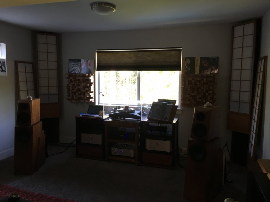

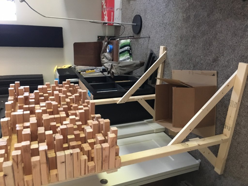

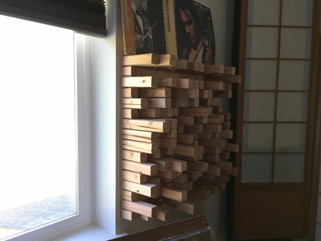

Here's howheres what I did...

Nice job. The Jeff Buckley album on top is definitely helping.  :thumb:   :icon_lol:
