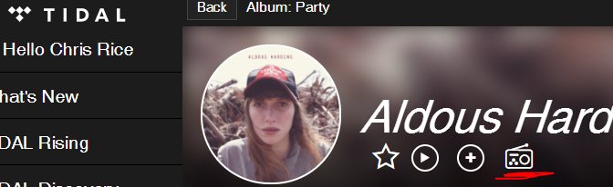

The next firmware release will see the addition of a button to add an artists radio playlist to the queue and the gapless playback will be fixed on the BDP-Pi, BDP-2 and BDP-3 (never existed on the BDP-1)
