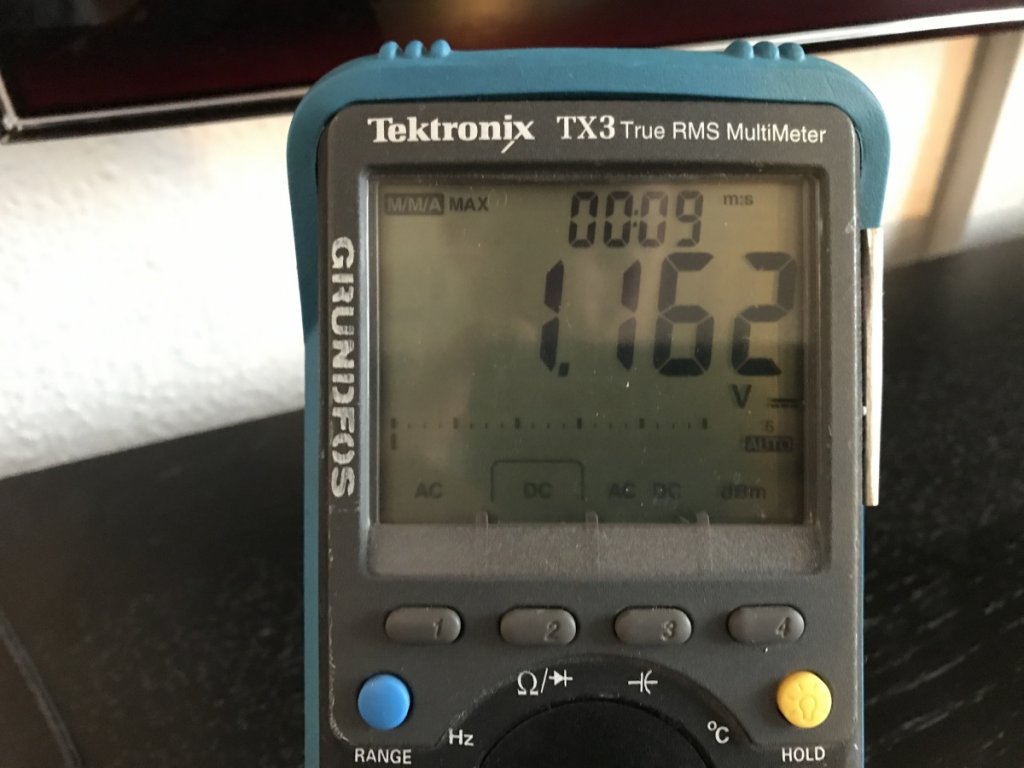

The problem with the NuForce is, that a loud pop occurs in the speaker driver if a protective capacitor is connected in series with the driver. With no capacitor in series with the driver little to no pop occurs. It seems the capacitor has the complete opposite effect of what is desired.
I measured DC across an output and it maxed out at 1.162 volts! As I'm inexperienced, I don't have anything to compare with, but it seems much too high. Am I right?
Also, here's a video clip showing power on, idle and power off with a multimeter attached: https://www.dropbox.com/s/qm3g83yjku7tfiz/2017-05-09%2020.13.30.mov?dl=0
