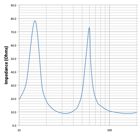

I have re-built an Altec Valencia 846B. I now have the 15" 416-8z woofer in the 6.6 cuft (185 litre) enclosure with the horn on top of the box. I have been re-tuning the enclosure and have found that the 'best' response curve and impedance plots have come with moderately low stuffing and what seems to be a very small port: 4" diameter x .75" deep -- basically a 4" hole in the front baffle (much like the classic Altec utility cabinets). The system is tuned to around 35Hz.
The goal of this project was never to get full deep bass. Currently everything sounds punchy and clear.
I have been reading about general port sizing. And most everything I find states that 4" is too small stating port noise as the major issue.
What are the consequences of a small port for such a large woofer?
Impedance plot below.

I've not measured these effects : http://www.subwoofer-builder.com/port-compression.htm
From a quick sim using some data I found on the web for the woofer, port velocity does get quite high but at low frequencies (< 40 Hz) and it's pretty high SPL.

Hi Nickd, I guess that explains the response curve I got... the port looked too short.
Steve, bear in mind those are "typical" recommendations - the velocity depends on the tuning frequency i.e. a sub tuned to 18 Hz will be a very different thing to your woofers. And, it also depends on SPL. Interested to know how you go.

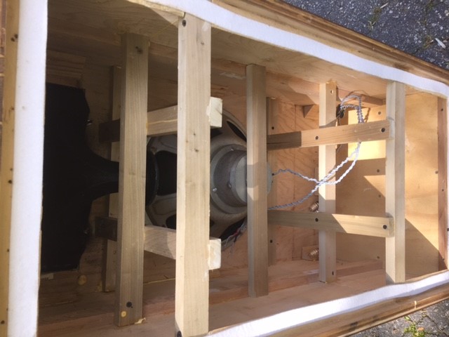

In my DIY 2 way, I am putting on various size back panels to experiment w port sizes. The differences aren't much. Even compared to a sealed cabinet. In fact, I have been experimenting w one speaker sealed and the other (see picture) w a port. I can barley hear the difference and the imaging is rock solid.
In contrast, taking out the internal dampening (3/4" wool covering all the walls) and replacing w bracing was a huge improvement. Now, I only have dampening on the back panel. Still tinkering here.
JLM
  • Posts: 10785
Some estimate that some very poorly braced cabinets (especially large unsupported open baffles) can produce more resonant spls than woofer.  But your bracing could be greatly improved by using window framing type design.  (Run bracing in a box shape lining the inside of the cabinet walls at intervals equal to the the cabinet width/depth and perhaps adding cross bracing or a sheet of plywood with a large hole cut out of it at midpoints of the box shapes.)

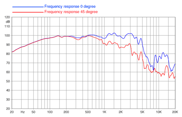

I think I should have said "The low-frequency response of a ported cabinet is determined by its volume, port length and area, and woofer parameters."
Midrange response is a different matter. Current "pro style" drivers often go out to several kHz (on axis) e.g. here is Faital Pro 15PR400 (15" woofer, modeled -3dB at 40 Hz, 118 dB midband SPL without exceeding Xmax from 35 Hz up):
OTOH "hifi style" drivers generally don't.
