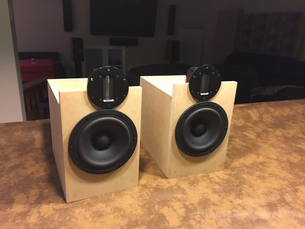

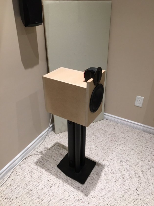

In any case, here is the result of my "woodworking" skills.  I made a few errors along the way, but recovered well enough to finish.
They are breaking in now.  If they end up sounding great, I will build nice boxes, and enclose the tweeter etc.  I know that there are likely many things to improve on vs the mules I built out of 3/4 mdf.  Rounding over the baffle would help.  Working with more traditional dimensions too (used scrap I had, and have only hand tools).

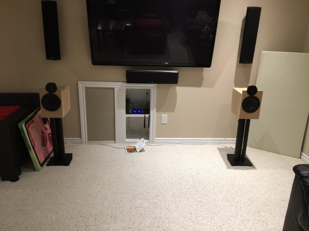

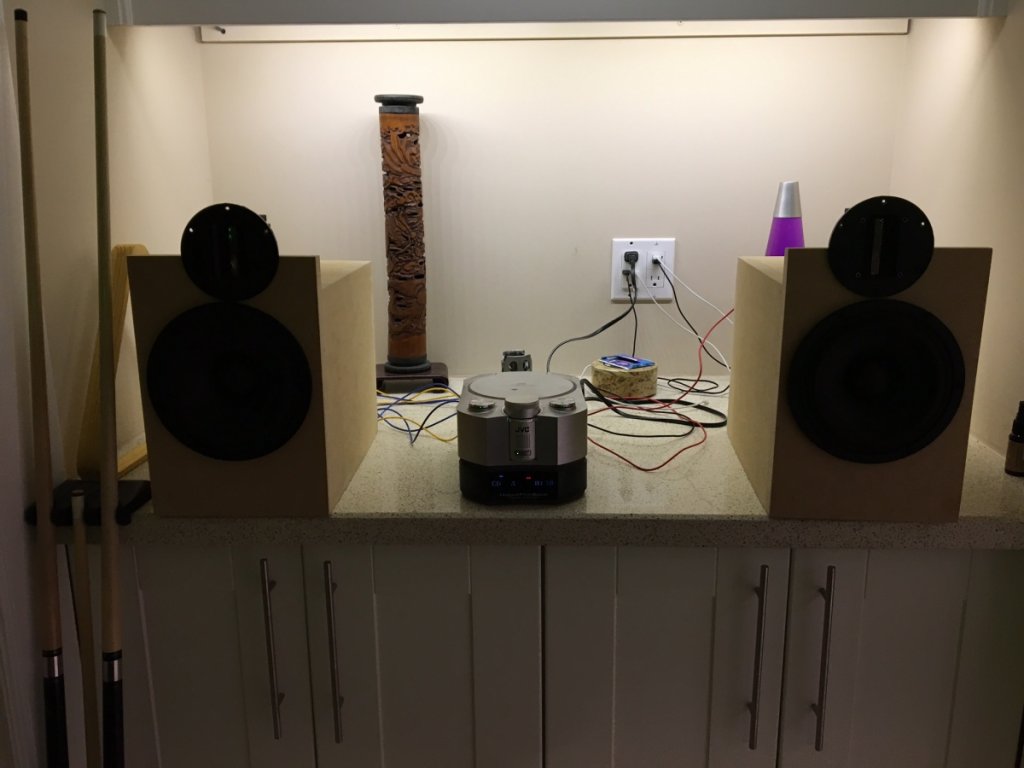

Below is a shot of my initial testing.  Did not want to risk any of my good gear, so I hooked them up to an old cd/radio combo.  Figured if they made music and did not blow up I would swap them into the main setup.
After proving I did not cross wires and blow anything up - here they are in the main setup.  Good thing the lights are usually off!

Cabinet - CSS designed this kit to fit the 0.38 Parts Express cabinets.  I built my own rather than buying those, as I was unclear how I wanted to implement these drivers.   My cabinets are radically different dimensions, but net out at the same internal volume.
Sealed or ported - Sealed.  I may experiment with a larger ported enclosure based on my past exposure to the RAW HT3 where a very similar woofer was used in a ~1ft box tuned to 28hz.
F3 - 55Hz is the -3dB point of the sealed box.
Tweeter - a CSS modified (unclear how) Aurum Cantus G2si
Woofer - CSS LDW7 - appears to be a modified Wavecor WF182BD04-1 - a 7 inch midwoofer
Xover - 2.5Khz 18db/octave.  Erse/Solen caps used.  Solen inductors.
Stuffing - I bought 16oz of polyfill.  I would say I have about 6oz left so I figure roughly 5-6oz in each sealed cab.
Sensitivity - low.  Specs suggest 84.5dB.  My twisting of the volume compared to my Focal Electra 906's would lead me to believe it.  The Focals are 91dB sensitivity.  No matter, my Audio Refinement amp has enough juice to power them no problem at the volumes I listen at (low 80's).  I have tried a lot of different combinations of speaker sensitivity and amp power.  In the end I have no issue with low efficiency/sensitivity speakers.  I know that many love higher efficiency, and I enjoyed them when I used them too.
Testing equipment - ears and iPhone with SPL meter.  So totally lacking.  But that is why I bought a proven kit vs attempting to design my own.
I let them run yesterday, and spent the evening listening.  I will continue to let them break in.
I will say that I am thinking through the next potential box implementation.  They sound good.  This kind of bass would satisfy many (tight sealed).  I may need a little more, so I will continue to explore ported enclosure possibilities.  I would intend to replicate the Xover the same way.
