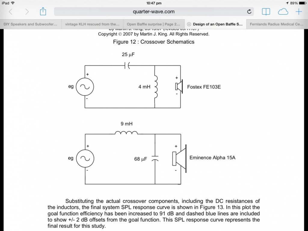

Crossover like MJKs OB Eminence alpha plus FE103

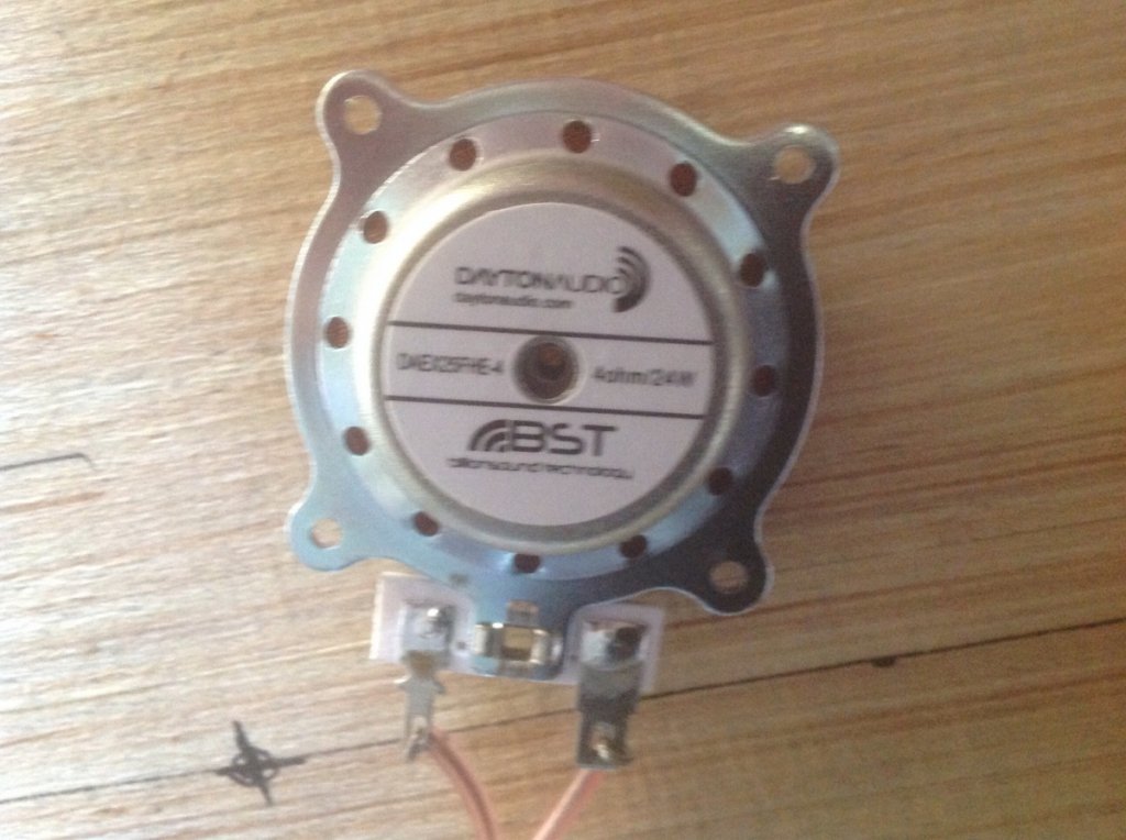

I planned to use cone woofers, but I am interested in what you used for  sub DML panel, XO details etc as the two DML panels should be easier to "blend" at the XO point having similar sensitivies and sound fields. What size and material sub panels did you use and how did you drive them? I have Dayton 24W exciters with the four metal mounting tabs on the magnet side.

1. DAEX30HESF-4 Exciter 40watts rms.....The DAEX25 is good also as it has the mounts to mount it on a spline/brace.
2. Panel material is Ultimate grade EPS 1inch think and 16inchesX24inches not by choice but by what was available from that company.
3. Driven by a 50 watt sub plate amp with variable crossover.
4. Exciter needs to be mounted to a spline attached to a brace to hold the exciter as well as the panel in place for high excursion out puts.
