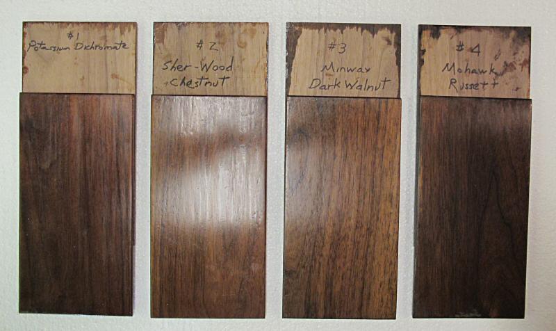

Looks like an ebony stain. Test the paint stripper first on the bottom, stain is hard to completely remove, you might end up with blotchy grey walnut speakers with black grain and areas of MDF where you sanded through the veneer.
The wood is walnut, I have gone through over 1000 bd. ft. of black walnut in the last year. The pores in red oak are much bigger.
Right now I'm working on a contemporary door with two walnut colors, natural and dark. The grain in my color samples look just like the speakers.

I stand corrected.  :oops:  Looked too open to me, in my very limited knowledge, but Wayne really is a hardwood expert.
I still wouldn't want to tackle refinishing what could be really thin veneer.
