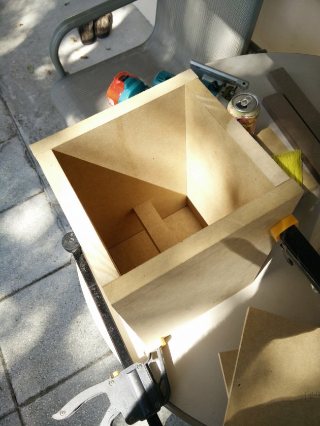

I had left off with dealing with building a new box for the speakers since the originals were overrun with mold; most likely due to me thinking the water putty filler was dry, and it was in fact, not.
At the time I had made another post asking for some guidance on my box design, which was a huge help: https://www.audiocircle.com/index.php?topic=149856.msg1602834#msg1602834
With very little skill, I had all the pieces cut out of 3/4" MDF:
Created a router circle jig from a spare vinyl flooring piece, and a wood screw spaced out to get the right diameter:
This worked, but was terrifying to use:
Box was mocked up with a small brace running front to back.
The box was later assembled with wood glue.

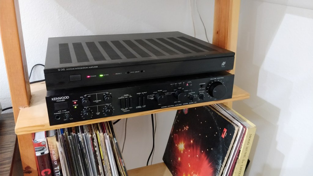

So, as I mentioned previously, I feel like I think they improved in sound, but wasn't sure.
Well, later that year in 2017, I had upgraded from my Kenwood KR-4070:
To a Kenwood Basic C2, and a Niles SI-245:
The improvement in sound going from the vintage Kenwood receiver to the amp/pre-amp combo was noticeable.
I feel like I couldn't critically compare the speaker upgrade, as the receiver was the limiting factor.
But the speakers sound great -- and have been for more than 5 years now with zero issues!
