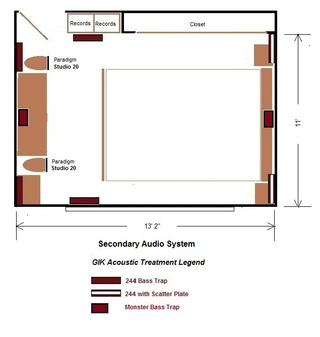

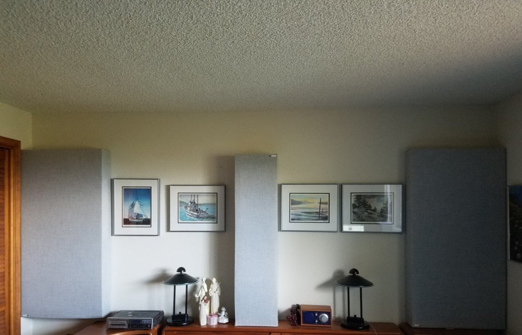

Re: When the back wall just HAS to be close to your head
« Reply #19 on: 7 Mar 2017, 10:22 pm »
Check out our panels with the ScatterPlate, and our Alpha Panels. I don't want to say they are equivalences, but they are in the same product category (ie, absorption and some binary amplitude diffusion together in one unit).
Late to the party, but I agree your suggestion's worth a try.  My listening position near bed center in my bedroom system isn't quite as close to the rear wall as the OP's--but having "borrowed" some scatter-plate as well as full-range 244's and 12"x48" Monsters from my main system to test various configurations, I found scatter-plate 244's at the corners and a full-range Monster at the center of the rear wall to offer the best subjective listening results. Here's a look:
