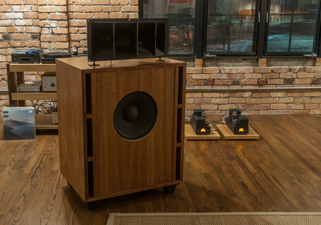

Macrojack,
Can you provide any more details on these horns? I currently have a pair of Onken cabs that I run with Altec 511B horns and Altec drivers. I would like to get away from the cast aluminum horns, but I'd like to stick with a 2-way configuration and so something that could cross low enough is a must.
Love the look of yours and wonder if they might be a viable option.

Woody,
Are you running Altec 416's or 414's on the bottom?  If you're running a 416 a two-way becomes a challenge and needs a driver crossed over fairly low (1,200 hz or so).  The 414 can run a lot higher and is easier to use in a two-way speaker.  Also, FWIW, a lot of people find the 511/811 horn to be very shouty.

These were actually built using a Dayton Audio woofer... the PA380-8... Here's the specs...
http://www.daytonaudio.com/index.php/pa380-8-15-pro-woofer.html
http://www.parts-express.com/dayton-audio-pa380-8-15-pro-woofer--295-034#lblProductDetails

« Reply #34 on: 14 Feb 2017, 01:05 am »
I'm not familiar with that driver, but you owe it to yourself to try a pair of 416's in the Onken cabinet.
If you don't like the 511 horns - and most people don't - you choose a number plastic or fiberglass horns from Autotech.  DIYSoundgroup has them in the US.
I like the Autotech horns. Which one would be the best choice? I'm open to changing the HF driver of course.

Woody,
Very nice speakers you got there. Yes, the horn as others have said is not one the best examples of the breed. It's not because it's a metal horn, but because of a pinch at the throat that creates diffraction which we're sensitive to, especially at higher SPL's. The Altec multi-cells that were recommended above as well as the 805B's, are really in another league as compared to the sectoral's (811/511). They are also quite a bit more rare and expensive.
I am at this point very close to ordering a Le Cleac'h type horn from Azura Horn, their model AH-425. This was a custom design for Lynn Olson that came out of the megathread "beyond the ariel" over at diyaudio. it was designed with the 1.4" large format compression drivers in mind such as the Altec 288 and Radian 745NeoPB.
