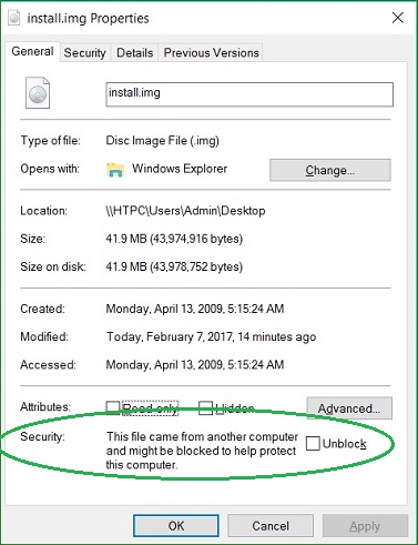

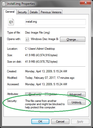

I downloaded some firmware upgrade files from the Nuprime site and they were blocked, but yours may not be.
This is the Properties dialog on Windows 7  (button)
and this is the Properties dialog on Windows 10  (checkbox)

Figured out how to unblock them. Now when i try to install in recognizes the USB and says it will begin to install then I get the same message as a progression screen appears at zero %
