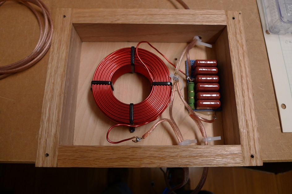

For info, this is a photo of the latest MMG crossover that I used:
The inductor is a 2.0mH Solen.
The capacitor is six 2.7uF Panasonic polys in parallel.
The tweeter series resistor is 1.5 ohms.
That setup works just fine.....IMO.
Dave.
