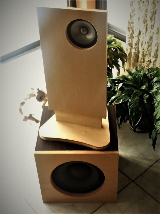

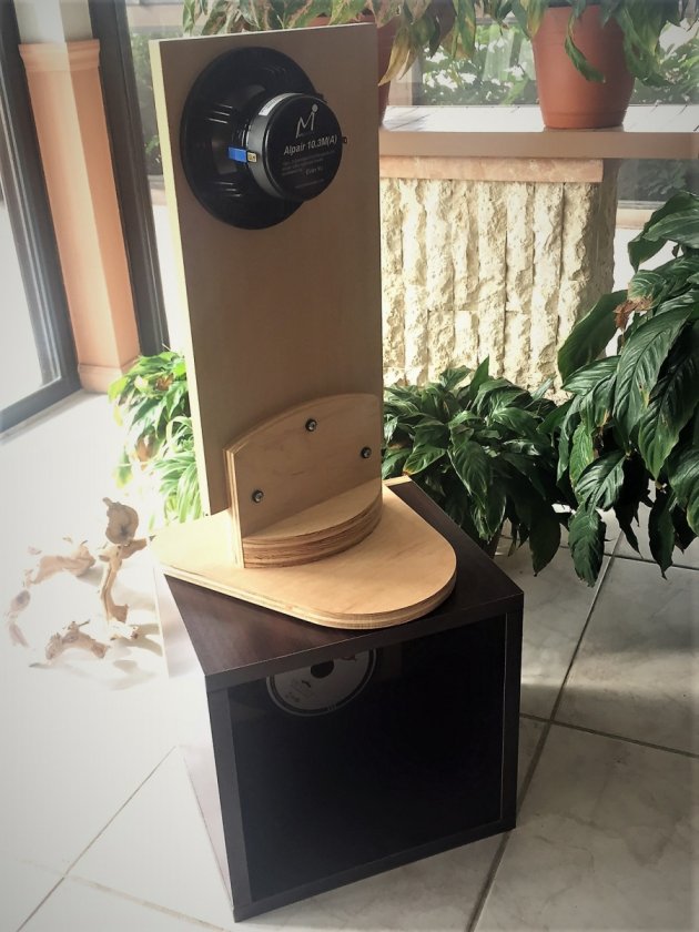

OB-GYN: “Open Baffle – Glassy Yet Neutral”.
Glassy yet neutral is perhaps the best description. Think Stevie Ray Vaughn on Little Wing or Knopfler on Sultans. These have a chimey, bubbly, and lively presentation.
Are they the last word in resolution? Nope. Do they produce bass you can feel in your chest? Not really.  Are they forgiving and fun to listen to?  You bet.
The OB-GYN is my attempt to build around drivers I had laying around. The crossover is purpose-built and the U-frame is pre-fab, sorta. In fact, the construction materials (less drivers and crossovers) were under a hundred bucks for the pair. The project was designed and built over a weekend.
More to come as time permits…

They look great.  Have you considered stuffing the box, ala cardioid?
matevana
Re: New OB Project: OB-GYN
« Reply #2 on: 16 Jan 2017, 01:46 pm »
Thanks. That’s a great question. The premise of stuffing a u-frame, as I understand it, involves damping the rear resonance which in turn alters the internal propagation delay. Once properly damped, (by adjusting the quantity of stuffing) the front and rear waves are summed and the level is then only down about 6dB at half the system’s monopole frequency, or roughly half that (or twice as efficient) of its true dipole equivalent. At this point LFE is typically applied to bring the direct response close to the targeted alignment and flatten the curve.
In an actively EQ’d system it sounds promising. This design however is passively crossed and the woofer that I had on hand is only about 5dB more efficient than the fullrange driver. Once you add passive components to the woofer for baffle step and low frequency equalization, the Alpair 10M requires about 12dB in attenuation to match the approximate output of the woofer. Shifting the LFE center point down another 20-30Hz, as a result of properly stuffing the box, would all but render the design useless from an efficiency standpoint.
I’d be willing to try damping the box w/o any additional compensation, but I suspect the response would be too irregular to be useful. What do you think?

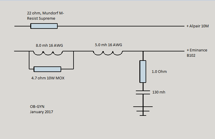

OB-GYN Crossover: A split series inductor topology shunted by a 4.7 ohm resistor provides the necessary LFE, in parallel with 130 mh of capacitance, providing a 175 Hz 2nd order electrical low pass on the woofer.
I tried to keep the Alpair 10M as vanilla as possible with a single, Mundorf 22 ohm M-Resist Supreme resistor yielding about 12dB of attenuation to match the woofer’s level post EQ.
While a high pass filter isn’t needed from a response standpoint (due to the drivers close proximity to the baffle edge and subsequent LF cancellation), you should use care and monitor the output level and subsequent distortion/excursion. For this reason, this system works best in a bedroom or den/office.
I experimented with adding capacitance to the Alpair 10M where greater SPL's are desired. Inexpensive electrolytic caps greatly detracted from the drivers sound, and midrange poly caps were only marginally better. If you choose to go this route, invest in premium quality metalized poly caps (i.e., Jantzen Z-Superior) and bank smaller values in parallel, or perhaps bypass larger value midrange caps with a single premium cap. You will require about 80 mh altogether. The top quality caps will really make a difference in this design but SQ-wise, it benefits from having no HP at all, provided reasonable output levels are observed.
