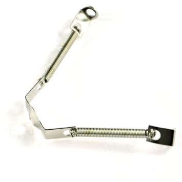

I'll have to get a picture of mine when I get home. Here's a picture of the same kind of retainer:
I use it because it came with the amp and I honestly don't know any better. I assume it's there since the tubes sit horizontally in the amp and Vox doesn't want them to wiggle loose. Should I just ditch them?

This image is suffice, as guitar amps may suffer beats and vibrations at transport the manufacturer provided retainer, if the amp will not be thrown in a truck or transported as it happens in pro audio world I not even would use the retainer as it increase tube microphony. But its me, I could press the tubes once a month though.
