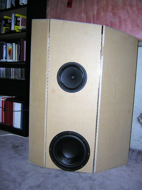

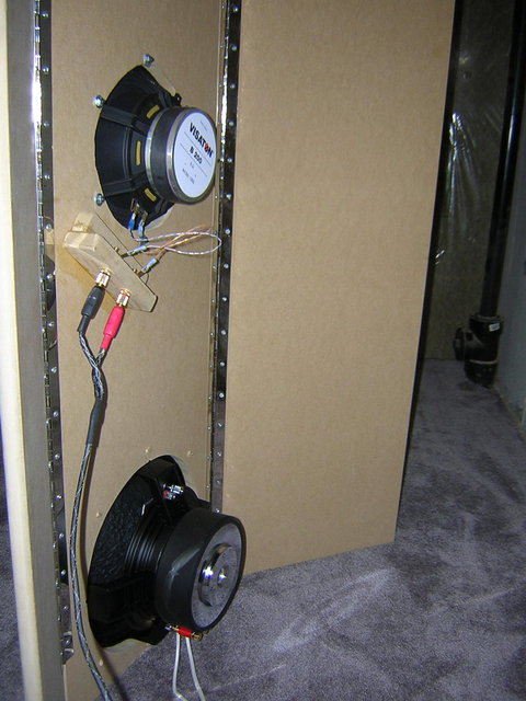

I owned and used the b200's for about 10 years on OB.
Omega used to build an aperiodic loaded box with the b200 (A8 I think?).
That is another option.
I have no insights into the Norh drivers, I have never played with those.

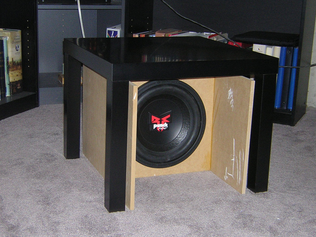

Here is an H baffle I used a car sub in, as an experiment.
