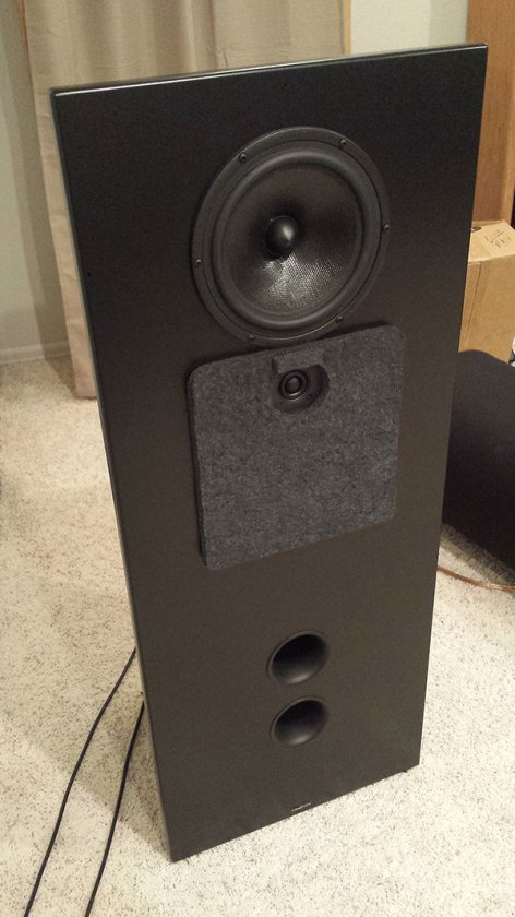

1st action based on years of dealing with baffle diffraction was F-11 .5" wool felt around the excellent Seas soft dome tweeter on this 17" wide baffle  - inch between tweeter, 4" to left and right, 7" below...looks like a rectangular beard on the tweeter. Immediate smoothing of treble response - those that have used felt know exactly what I mean.

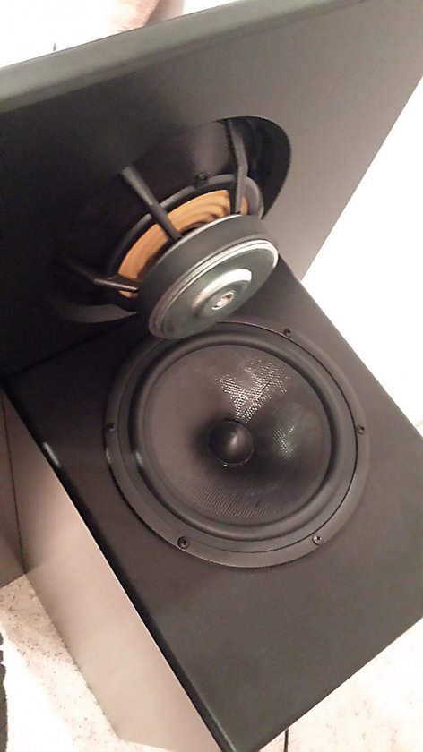

Thanks for the write up. Have you got pics of your Sigmas?
Here's a couple I took setting up....

fidobite, I see you have a circular cutout for the felt around the tweeter. You might want to experiment with that shape if it's feasible. I have found that you can hear cavity resonances even in felt and that the ideal shape is a star pattern, or at least a square, counter-intuitive though that may seem. With a square cut out, at least you benefit from varying distances from the source to the felt. If the felt absorbed 100% of the sound energy it wouldn't matter, but it won't and there's the rub.
What originally alerted me to this effect was trying to record wind in trees for a film and keeping the wind out of the mic by recessing it in a circular wall formed by a fiberglass batt. To my amazement I could hear the tuning effect of the cylinder of fiberglass. I would never have believed it possible, but I happen to recognize the sound of what amounts to a cavity resonance, and when I moved the mic in and out of the cavity, I could hear the tuning change, like comb filtering.
fidobite
  • Posts: 17
Re: Tekton Design OB Sigmas quasi-dipole open baffle speakers
« Reply #8 on: 15 Jan 2017, 03:21 am »
Thanks Russell! I had seen that done but didn't really understand the reason...now I've been "educated" and your description makes perfect sense. That will be my next project...now if I can just cut it accurately without making a mess of it  :?
